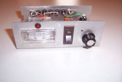

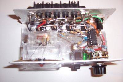

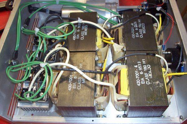

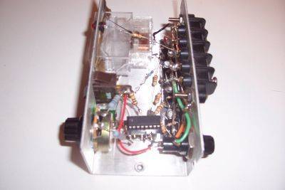

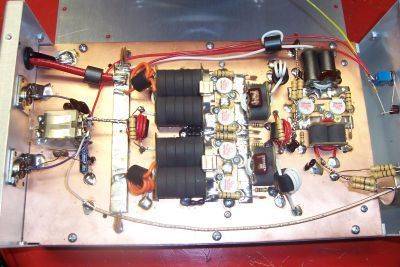

I am truly sorry for my stupid questions, but I have to learn more somehow, and why not from the masters... Here are a few of my projects that I have completed...
Your questions are not stupid, and your project pictures are very nice. Here's the wikipedia article on voltage regulators for background info:
