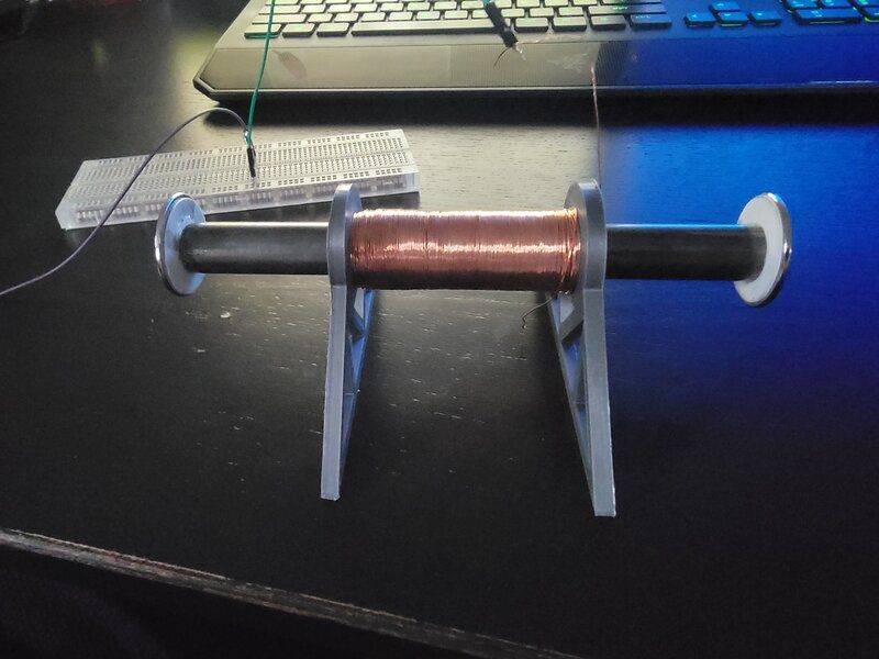

I am currently trying to create a linear induction motor for fun and am having some trouble getting it to start oscillating or move at all. I am using this video as a reference...
I am using 3D printed PLA as the structure for the copper to wind around, 26 GA Craftware USA copper wire, 5/8" cold-rolled steel round from the hardware store, neodymium magnets each 0.5T, and a DC power supply at ~5V and ~0.4A (I have a breadboard with a 10ohm resistor in series to allow for the higher voltage).
The spool for the copper to wind around is 0.1" thick and has 6 layers of 250-280 turns of wire.
I was thinking of first increasing the layer count and maybe change to a smaller diameter rod.
I also have a flux sensor on the way so I currently do not know the strength of the induced field.
If someone could give some advice or a flux model that captures the setup, it would be greatly appreciated.
Thanks!

Can you post a picture of your setup versus the one in the video?
This is currently what it looks like.
1. are your magnets attached with the correct polarity - the two right hand ones should be repelling.
2. when the coil is energized, the right hand one should be attracted to the coil and the one on the left should be repelling the flux.
3 the base holding the coil has to be correctly positioned so that the rightwards extension of the rod closes the switch, activates the coil, which provides the flux to push out the left magnet, and at the same time overcome the repulsion of the left stationary magnet.
4 setup is important. It looks simple. but as a resonant circuit isn't

I also thought that would be the problem, but once my flux meter arrived I found a different problem. The flux field emitted from my coil was none existent. I took some time to think about it and I was wondering if it had something to do with the fact I was using uncoated copper wire. Do you think that could be the reason?
Was that with or without the steel rod inserted?
Also, you would get better results with 'soft iron' which may not be readily available. If your steel is cold rolled, its permeability may be improved by annealing it. To do this, remove the magnets(!) and bring it to cherry red with a blow torch and remove the heat over a period of a few minutes, to slow the rate of cooling it. Depending on the strength of flame you can get, you could bury the rod in some sand (in a tin) for the process, which will slow down the cooling further. Perhaps a PF expert could confirm this may be worth while. If you have a blow torch, it may be worth trying the experiment.
PS Have you checked that current is actually flowing in the circuit (sorry if that's very obvious)? Brushing wires together should give tiny sparks and you should expect the wires to get warm if there's significant current flowing. Contacts could be poor.
I just read this. The wire has to be insulated (enamelled) or you will have a short circtuit where the wires touch at the start of the coil - no current through the coil. Use enamelled wire and clean off the ends.

Seems to be bare wire is right.
https://craftwireusa.com/collections/copper-wire-spools
That would be a problem for sure.

Well, when the rod was in it only read the flux value of the rod itself while the current was passing through. Without the rod, it was nonexistent. Yeah, I definitely messed up buying noncoated wire. 😅 Also, I'll try annealing it in the meantime because I do have some soft iron on the way.
Looking at the data in the above link, soft iron should make a big difference. BUT if you had used the right wire from the start, you would already have a working motor, I think and you wouldn't have to be talking to PF.
