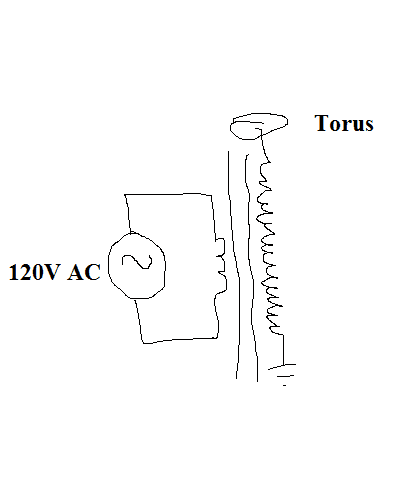

I understand how the tank circuit works, I just don't understand its purpose entirely. In theory, you could omit the tank circuit and spark gap and just have one monstrous transformer right? I have attached an image of what I'm talking about; please, no compliments on the art skill.
MacDaddio said:
I understand how the tank circuit works, I just don't understand its purpose entirely. In theory, you could omit the tank circuit and spark gap and just have one monstrous transformer right? I have attached an image of what I'm talking about; please, no compliments on the art skill. View attachment 75902
Looks to me you don't understand. Classical transformer alone can't replace role of a primary tank circuit. Tesla coils are high frequency devices, 60 Hz is too low for them.
So you are saying that the purpose of the tank circuit is to increase the operating frequency of the secondary coil?
Why do Tesla coils need to be run at high frequencies? And what frequencies are you talking about: kHz?
No. The secondary coil has it's own resonant frequency fs, just like every LC circuit. Problem is that air core secondary coil must be of colossal size in order to have low fs. One can significantly lower fs by connecting big enough capacitor to the secondary terminal. However, this will significantly lower output voltage too. Also, making secondary coil with too many turns , to significantly increase inductivity and lower fs isn't good. Therefore, primary tank circuit must have high frequency fp too to satisfy resonant condition fp=fs.
