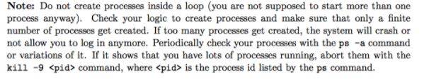

This is what I did but I'm getting an infinite loop of the reversed string whenever I run the program. I don't know why

looks like index decrements without bound...
Likes FactChecker
Can you explain what you mean sorry?
index-- has no lower bound, in other words how does it know when to stop when it gets to 0? I can't help you trace it because I do not have <unistd.h>...i.e. it isn't a part of Visual Studio 2015...
