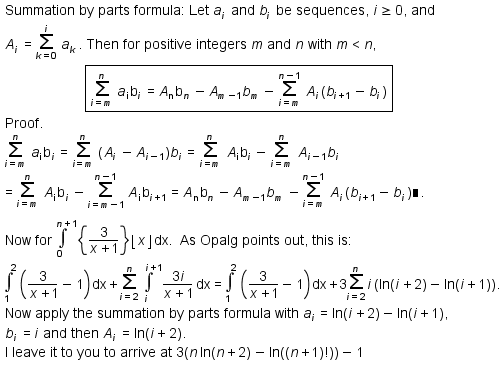

Hi,
Opalg certainly pointed you in the right direction. The following should help you to arrive at a relatively simple formula.
