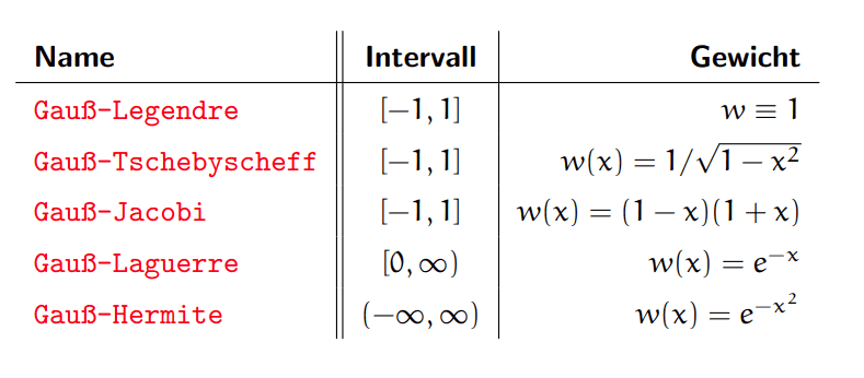

I found now the below table:
Does this mean that since we have an integral of the formm $\int_{-1}^1f(x)\, dx$, i.e. $w\equiv 1$ we use the Gauss-Legendre?
If we would have an integral of the form $\int_{-1}^1f(x)\cdot \frac{1}{\sqrt{1-x^2}}\, dx$ we would use Gauss-Tschebyscheff, etc? Or since we have the function $f(x)=e^{-\frac{1}{x^2}-x^2}$ we write it in the form $e^{-\frac{1}{x^2}}e^{-x^2}$ and we use Gauss-Laguerre for example consider the function $e^{-\frac{1}{x^2}}$ ?
:unsure:
It depends on what $f(x)$ is. If it is a function that behaves like a polynomial, you are right.
If $f(x)$ is a polynomial divided by $\sqrt{1-x^2}$, we should use Gauss-Tschebyscheff. (Wondering)
That's a possibility yes. 🤔
