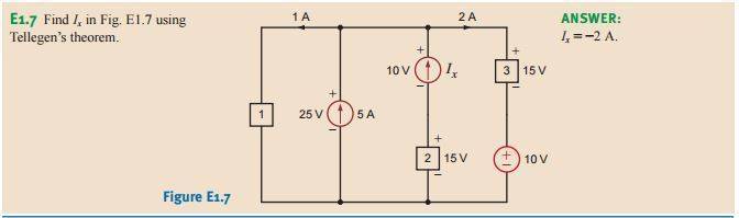

Calculate Ix Using Tellegen's Theorem: -2A

octavio10
1. Find the current Ix using Tellegen's theorem2. P=VI3. 10*-Ix+ 15*2 +15*-2+10*2=0
-10Ix=-20
Ix=2A
But the answer is -2A.
Circuit schematic for Fig. E1.7 with a 1 A source, 25 V and 5 A sources, 10 V and 15 V dependent or labeled elements, currents 2 A and Ix, and boxed branch numbers 1, 2 and 3.
Please explain each term in the equation you've written, and why you omitted some terms.
