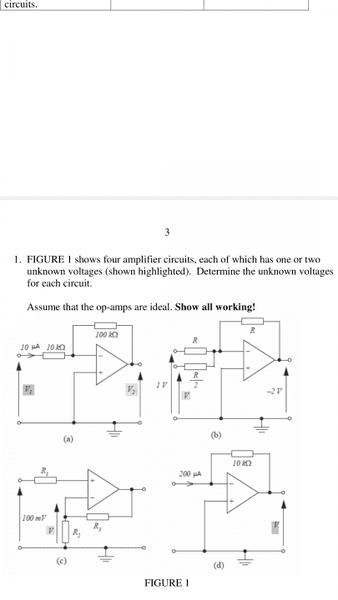

Hi
Does anybody have any useful material on how to calculate unknown voltages in an amplifier circuit.
Thanks in advance.
Yes. But there are many different types of circuits. It is best to attach a picture or post a link to the actual circuit.
We can then show you how to find the unknown voltage.

Here are the circuit examples. Thanks
  • Figure 1 with four op-amp circuits labelled (a) to (d), each with an unknown voltage highlighted; resistors are marked 10 kΩ, 100 kΩ, R, R/2, R2 and R3, and sources include 10 µA, 1 V, −2 V, 200 µA and 100 mV.

Hints for circuit a)...
There is an input current specified.
For the op amp to be operating in a linear mode what must the voltage be on the -ve input?
If the input impedance of the opamp is high, where does the input current go?

Hi Thanks for the reply. I am just starting out with learning about these circuits so my original question was does anybody have any material that can help me understand how to calculate unknown voltages in these types of circuits. The image is an example of what I am working towards solving. The hints are much appreciated though.
You need to know that ...
An op-amp output voltage rises if input(+) is greater than input(–).
The op-amp output voltage falls if input(+) is lower than input(–).
That means that when input(+) is equal to input(–) the output will be stable.
Currents flowing through resistors drop voltages. Ohms law. V = I * R.
Chains of resistors form potential dividers.
Start here with op-amp circuits.

Thank you for all of the information there is a lot of it! I am still trying to figure out how to calculate the unknown voltages and I have looked everywhere for a worked example to show how to calculate the unknowns. It is probably staring me right in the face in the materials you have given me! Does anybody have a worked example of a how to find these unknown voltages? I am a bit overwhelmed by the amount of information out there.
My simple rules from post #6 hold.
Here is the first solution. Fig.1.a.
Negative feedback through 100k makes both op-amp inputs ground potential.
Input current is 10uA, input resistance 10k, so Ohms law says V1 = 10k * 10uA = 100mV = +0.1V
There is no current flowing in either ideal op-amp input terminal. So current through 100k must also be 10uA.
The input current of 10uA flows down on through 100k.
Therefore V2 = zero volts – (100k * 10uA) = –1000mV. Therefore V2 = –1.0V
