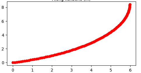

It's not easy to explain the problem...
Basically what I want to make the curve below in 3d instead of 2d:
Which is basically created like this (which is a recurrent function):
Python:
                x_coordinate = (coordinate_current + math.cos(math.radians(angle_current))* length / step_resolution)
                y_coordinate = (coordinate_current + math.sin(math.radians(angle_current))* length / step_resolution)
I think what I have to do is to create the curve in 2D as I've been doing, and then rotate it into 3D using the techniques in this video (x-,y, and z-rotation matrices):

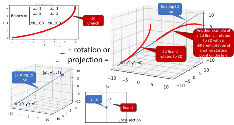

I realize that it is not easy to explain this problem, and have tried to sketch it below. Basically, I want to project my curve/branch (which is a list of 100 x-z coordinates) onto an existing line which is defined by the two point illustrated in the figure. To make it simple, let us assume that the curve/branch starts at (x0, y0, z0) which is a know point on the 3d line. To orientation the curve, we use an angle "alpha" around the axis of the 3D line from vertical (z).
Does that describe the problem better?
Kind Regards,
Peter
But these are just generic curves. In order to write down mathematics there must be some equations describing the curves. Or, at least a description like "parabola".
This is for a software and what I need are the rotation or project matrices.
The curve is defined as a collection of points (its will eventually become too complex to describe with a simple formula as every curvature between each point will be a probabilistic varying). The line is also clearly defined so all the necessary information is there I think..
If we imagine that the original line is the z-axis. At some point ##(0, 0, z_1)## the first branch occurs into some 2D plane at a random angle ##\theta_1## in the x-y plane. If, for example, ##\theta_1 = \frac \pi 4##, then the plane is defined by the z-axis and the line ##(1, 1, 0)##. In general, the plane would be defined by the unit vectors ##(0,0, 1)## and ##(\cos \theta_1, \sin \theta_1, 0)##.
Then, at subsequent points ##(0, 0, z_m)## a branch occurs into the plane defined by ##(0, 0, 1)## and ##(\cos \theta_m, \sin \theta_m, 0)##.
Is that what you want? Assuming the original line is the z-axis, for example.
Ok, let us imagine that we have a plane which is formed by the 3 points:
  1. (x0, y0, z0)
  2. (x1, y1, z1)
  3. (x1, y1, z1+k),
where k is a number > 0. This plane now goes through all the points of the 3D line and is vertical.
Now, I want to project my curve onto that plane such that my x-axis from the 2D curve lies on top of the 3d line within the plane.
Finally, I can now use an angle "alpha" to rotate my plane (which is currently vertical) around the axis of the 3D line. So if alpha is pi/2 then the plane will become somewhat horizontal...
Does that makes sense?

Possibly, but it's not very precise. I suggest it's easier if you describe what you want to do using the z-axis first, starting at the origin. Then, once you know what you're doing mathematically in that case, you can map that solution to the general case.
My description above was based on those diagrams you posted.
I suggest a two step process: describe the curve generation in the simplest coordinates; then map that solution to a general point and orientation.
I think your idea is a good strategy, but I think I'll be able to figure it out.
So far, I got the branch on the line - now I just need to apply the rotations.

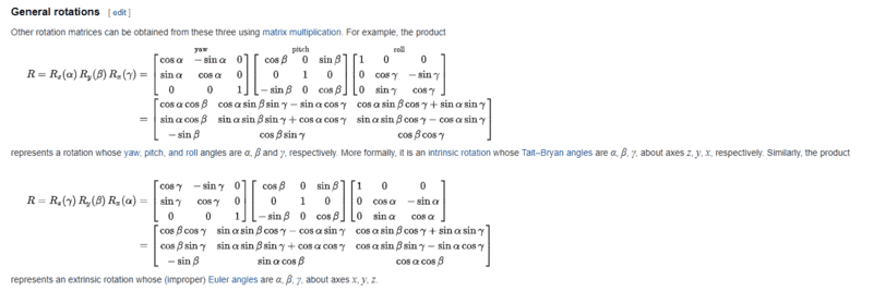

I'm typing this in now (https://en.wikipedia.org/wiki/Rotation_matrix) - and just have to think about how I calculate my yaw, pitch and roll...
Then I can rotate in my curve in the local coordinates system and project the curve onto the 3d line and global coordinate system
Any ideas on how to determine yaw, pitch and roll feel free to bring them up :biggrin:

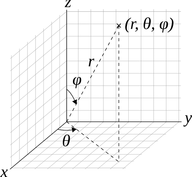

Note that if we have a unit vector ##(n_x, n_y, n_y)##, then that translates nicely to ##(\sin \phi \cos \theta, \sin \phi \sin \theta, \cos \phi)##. Then, what you need is a rotation of ##\theta## about the z-axis and a rotation of ##\phi## about the new y-axis.
I think that's the coordinate transformation you want, followed by a translation to the branching point.

No. Your problem is defined by two things:
1) A point on a line in space. The point has coordinates ##(x_0, y_0, z_0)## and the line is defined by a direction, which is represented by some unit vector ##\hat n = (n_x, n_y, n_z) =(\sin \phi \cos \theta, \sin \phi \sin \theta, \cos \phi)##. Where ##\phi, \theta## are the spherical angles if that vector were placed at the origin.
Note: sometimes it's simpler to deal with the vector as simply ##(n_x, n_y, n_x)## and sometimes expressing it as ##(\sin \phi \cos \theta, \sin \phi \sin \theta, \cos \phi)## is useful.
2) You want something to happen at that point, which presumably depends on not just the point but the line. All your diagrams show a curve branching off from a predefined line in some way.
Note that I'm still not sure what this branching process entails, but see below.
What I'm saying is that to try to describe or code 1) and 2) in general is too complicated. And, from both a mathematical and coding point of view, it's not very modular. You have one massively complicated process.
My suggestion is to break the problem down into two steps:
Step 1: take ##(x_0, y_0, z_0) = (0,0,0)## and ##\hat n = (0, 0, 1)##. I.e. the point is the origin and the line is is the z-axis.
Describe (and code) your branching function in that simple case. This would also allow you unambiguously to define your branching process and we can see what you are trying to do.

Hi PeroK
I finally got the time to work on this again and have solved it.
So, what I did was basically to use rotation matrices RxRyRz on my 3d curve.
Here is a simplified version not using tensors which is easier for you to read.
Python:
# rotation around X-axis:
        curveRotatedY = (
            math.cos(rotationAngleAroundXAxisRadians) * curveY
            - math.sin(rotationAngleAroundXAxisRadians) * curveZ
        curveRotatedZ = (
            math.sin(rotationAngleAroundXAxisRadians) * curveY
            + math.cos(rotationAngleAroundXAxisRadians) * curveZ
        # rotation around Y-axis:
        curveZ = curveRotatedZ
        curveRotatedX = (
            math.cos(rotationAngleAroundYAxisRadians) * curveX
            + math.sin(rotationAngleAroundYAxisRadians) * curveZ
        curveRotatedZ = (
            -1 * math.sin(rotationAngleAroundYAxisRadians) * curveX
            + math.cos(rotationAngleAroundYAxisRadians) * curveZ
        # rotation around z axis:
        curveX = curveRotatedX
        curveRotatedX = (
            math.cos(rotationAngleAroundZAxisRadians) * curveX
            - math.sin(rotationAngleAroundZAxisRadians) * curveY
        curveRotatedY = (
            math.sin(rotationAngleAroundZAxisRadians) * curveX
            + math.cos(rotationAngleAroundZAxisRadians) * curveY
The rotation angles are calculated using arctan2 with some additional logic.
