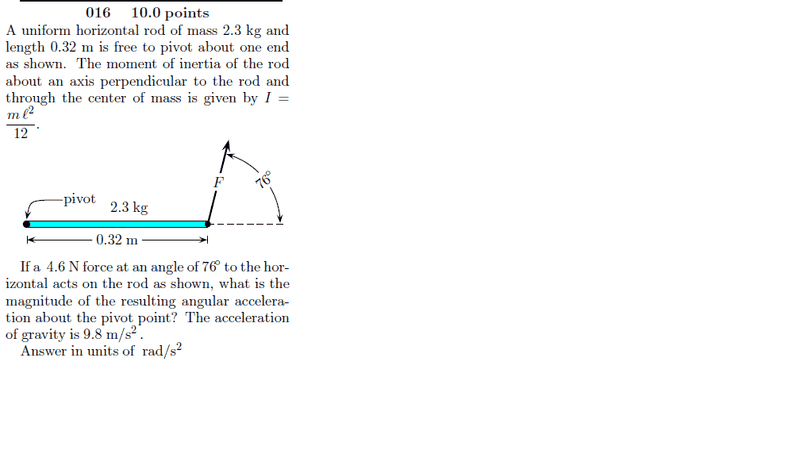

A uniform horizontal rod of mass 2.3 kg and
length 0.32 m is free to pivot about one end
as shown. The moment of inertia of the rod
about an axis perpendicular to the rod and
through the center of mass is given by
I = (ml^2)/12
If a 4.6 N force at an angle of 76 to the hor-
izontal acts on the rod as shown, what is the
magnitude of the resulting angular accelera-
tion about the pivot point? The acceleration
of gravity is 9.8 m/s2 .
Answer in units of rad/s2
torque = r * F
I = (ml^2)/12
torque = I[itex]\alpha[/itex]
I = ml^2/12
=((2.3)(0.32)^2)/12
=0.019626667
torque = r * F
= 0.32 * 4.6sin 76
=1.428275309
1.428275309 = 0.01962667[itex]\alpha[/itex]
[itex]\alpha[/itex]= 72.77216711
a=r[itex]\alpha[/itex]
=72.77216711 * 0.32
=23.28709348
BUT it's wrong...
Hint: is the pivot point of the rod located at the center of mass?
oh do i use parallel axis theorem here?
