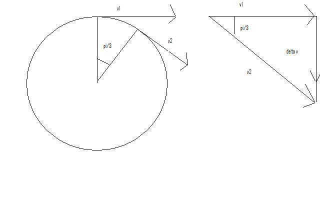

I've already told you exactly what to do here.
You want the actual velocity (as vectors) at two instants 5 minutes apart.
Pick some arbitrary position, the bottom of the wheel, say. What is the tangential velocity of that point (a vector)?
5 minutes later, the wheel has rotated π/3. That point will have the same tangential speed but in a different direction. What is the new velocity vector? What is the difference of the two vectors?

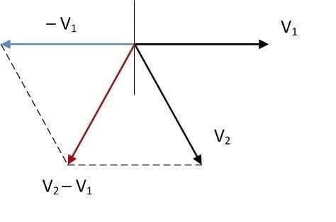

Hello negation. Appreciate your hard work. You 've got most of it but the ciphering creates mist and confusion. I don't think a little help is a spoiler at this point:
In your picture in #14 you have two vectors: v2 and v1. Draw them again in a new picture, where both grab at the origin. The angle between them is known, right? (Hint: don't use a calculator. Numbers like 0.523 -- which you later corrected to 1.047197551... -- are a lot less helpful than numbers like π / 3). Draw -v1 and then v2 + (-v1). That is the change in the speed vector in 5 minutes. Note it is a vector and it doesn't point downwards. The magnitude is evident. Divide by 5 minutes and you get the average acceleration vector. Its length is π m/min2. (Exactly. The 8.73... is only an approximation for π/3600. On the other hand, vela's 10-5 seems to be a typo to me, so your -4 is better...).
If you want to learn something, repeat the exercise for 1 minute instead of 5 and so on, all the way to dt = 0. If all is well, you just might end up with the 9.138 * 10-4. Or, more correctly ω2 r being π2/3 m/min2.
Don't let the hard work of calculating distract you from the insight: the instantaneous acceleration and the average acceleration are quite different beasts!
You'll know you understand it completely if you can swing a small weight at the end of a rope: what do you do to get it to go in a circle and what do you do to keep it circling...

  • #51
I have no problem spending days solving a problem. My life revolves around physics and math. I'm not satisfied leaving a problem unsolved. But indeed, this question is a real pain mainly because the definition of the terms comes across as rather chaotic to me.

Your drawing in #14 shows two vectors. But they are attached at different points, so it's a little difficult to draw the difference vector. I tried to explain it stepwise: a-b = a+ (-b), even in the vector world. The word grab confused you, but I was afraid the words start or originate would also do that...
My impression is yes, they want the average acceleration going from vector velocity 1 to vector velocity 2. v2 minus v1. Better not use the term tangential velocity here to prevent someone from thinking it concerns a number.
And yes, in circular motion radius vector and velocity vector are perpendicular (otherwise it wouldn't be circular).
The red vector is v2 - v1. In other words, the average vector change in vector velocity. Divide by time and bingo.
The angle between v2 and v1 does look pi/3 so it makes sense. It would make more sense if [v2+v1]/300s.
What is the significance of -v1? I'm puzzled with the set up of the diagram.
The angle between v2 and -v1 does looks > pi/3 so I was wondering why do you take v2+(-v1)
part(a)
[p(2)-p(1)]/300s
p(2) = [ 75m sin (pi/3) , 75m cos (pi/3)] = (65m , 38m)
p(1) = [75m sin(0) , 75m cos(0)] = (0m , 75m)
[p(2) - p(1)]/300 = (0.22i + 0.13j)ms^-1
part(b)
t = 0;
v 1 = r.ω = 75m [0 rad/ 75m] = 0 rad ms^-1
t = 5;
v2 = r.ω = 75m [(pi/3)/75m] = 0.261799386 rad ms^-1
v2 - v1 = 0.261799387m rad s^-1 = Δv
a→ = v→^2/r = (0.261799387m rad s^-1)^2 / 75 = 9.138...e-4
  • #56
The angle doesn't just look like that, it IS. Remember the change in Θ = 2π/30 . 5 . The change in vector velocity v is what you need to change velocity vector v1 into vector v2. That is v1 -v2. That is the red vector: When you take add v1 and add the red vector you end up at v2. Now two equal length sides at π/3 make an equilateral triangle. So the length of the red vector is also 5 π m/min.
Average acceleration = (change in vector velocity) / time = (5 π m/min) / (5 min) = π m/min2, with a direction as given by the red vector. Horizontal component -π/2 m/min2, vertical component -1/2π √3 m/min2. Divide by 3600 to get m/s2.
Your drawing in #55 shows two equal length vectors on the left but on the right you draw v2 much too long, suggesting that delta v points straight down!
Then, in part (a), you calculate change in position / time. That gives you the average velocity vector. Not helpful for the average acceleration.
Some improvement is possible: we go from [0,75] to [65,37.5] so that gets us [0.216506351 -0.125] m/s on average . i.e. 0.25 m/s speed, less than the π/12 !

  • #59
The 5 pi m/min is 2pi radians, a full circle, times the radius, divided by 30 minutes
  • #60
Continuing with part (b). You are falling back to scalars again! Do I read a v1 = 0 here ? Of the kind rad m/s ?
But you divide by meters !?
That can't be a speed, velocity, whatever!
If you want to do it analogous to what you did in part (a):
t = 0: v1 = [ 2π/30 * 75 , 0 ] m/min
t = 5: v2 = [ 2π/30 * 75 cos(π/3), -2π/30 * 75 sin(π/3) ] m/min
t = 0 to 5: average a = Δv/Δt = 2π/30 * 75 [1- cos(π/3), -sin(π/3) ] / 5 m/min2
Or, again, π [-1/2, -sin(π/3) ] m/min2 magnitude: π
And, just like with the average velocity, the magnitude of the average acceleration vector is a little less than the instantaneous acceleration (which was π2/3).
you re-calculate v2/r which gives you the magnitude of the instantaneous acceleration.
