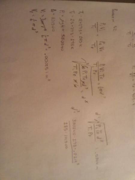

A diver 38.8 m deep in 14°C fresh water exhales a 2.19 cm diameter bubble. What is the bubble's diameter just as it reaches the surface of the lake, where the water temperature is 25°C?
PV=nRT
I don't know where to start on this problem at all I can find the intial pressure of the bubble but I don't see how that matters?

I am still wrong here is my work...
By the way, 38.8 m / 10 m = 3.88, not 3.38 as you have written.
it is attached
Your attachment won't be approved right away (I can't see the image). If you want immediate help, use a free online image hosting service to post the image, or type up your work.
PiVi/Ti=PfVf/Tf solved for Vf
Vf=PiViTf/TiPf then plugged in 1/6d^3 for the volumes and then found out that...
df^3=PiTfdi^3/TiPf...(380240*298*.0219^3/(285*101300))^1/3 and then got .125 m

Oh right, but it cancels either way
that is the work i did before i switched the pressure so the anwser i really got is not .0344 m( either way that's wrong too) but .1235 m
The initial temperature is 287 K, not 285 K.

Here's what I have:
[tex]V_f = \frac{P_i}{P_f}\frac{T_f}{T_i}V_i[/tex]
[tex]\frac{\pi}{6}d_f^3 = 3.88\frac{298}{287} \frac{\pi}{6}d_i^3[/tex]
[tex]d_f = \sqrt[3]{3.88\frac{298}{287}d_i^3}[/tex]​
Is it any different from your work so far?
EDIT: I see you have exactly the same thing as I do. So, do you get the right answer with the corrected numbers?
nope it is the same except i changed my pressures to Pa instead of leaving it in atms like you.

Yeah that's a good point. If I don't use the approximation, I get that the ratio of pressures should be closer to 3.76 rather than 3.88.
Also, your initial pressure seems a bit off.
And doesn't 1 atm = 101 325 Pa?

Edit: I think I was just being stupid. [itex]\rho gh[/itex] is the pressure CHANGE (Pfinal - Pinitial). Therefore, the pressure at the original depth is:
Pinitial + [itex]\rho gh[/itex]
I knew that.
Another way to think about it using the approximation is that if it increases by 1 atm every 10 m, then the pressure at 38.8 m is given by
1 atm + (38.8 m)*(1 atm/10 m) = 1 atm + 3.88 atm
emphasis on the PLUS sign, LOL. Duh!
so instead of Pi=density*g*h it should be Pi=Pf+ghdensity?
Yeah. I guess our definitions of "initial" and "final" were reversed because I was going downward from the surface (in the direction of increasing pressure), and you were going upward (like the bubble).
For absolute clarity:
(pressure at depth h) = (pressure at surface) + density*g*h
OOOOOOOOh makes since now
I got .0373 m but that is still wrong!
