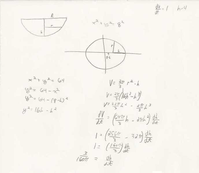

Water is dripping into a hemispherical bowl with a radius of 8 cm at a rate of 1 cubic cm per minute. At what rate is the depth increasing when it is 4 cm.
A) 1/96π
B) 1/48π
C) 1/24π
D) 1/16π
E) 1/8π
V = (4πr3)/3
and any other relevant equations, but that's the only one I know of that will help.
V = (4πr3)/3
and...that's about it. B is the correct answer btw.
dV/dt = 4πr2(dr/dt)
-1/(4π) = r2(dr/dt)
when h = 4, then r = 4
-1/(4π) = 16(dr/dt)
-1/(64π) = dr/dt
But...that can't be correct.
Since dr/dt is decreasing, dh/dt has to be increasing.
Anyone?

so what i think you did here is differentiate the volume of a sphere, which doens;t work for this problem,
it only applies if you are expanding shperically, (ie effectively addind or removing spherical shells of volume
Ok, I tried a different approach to this, but still didnt get the right answer.
Sorry for the large image.
Oh...
Ok...
So if I look at it as being composed of tiny slices, each of Δh height and of ΔV volume I get:
ΔV = (π)(r2)Δh
1 = π(16h-h2)Δh
1 = 48πΔh
1/48π = Δh
But, why doesn't the other method (the one in the image) work?
I guess its because V doesn't equal (2π/3)(r2)h
V = ∫ πr2 dh and then the derivative of that is just dV/dt = πr2(dh/dt)
Any ideas?
