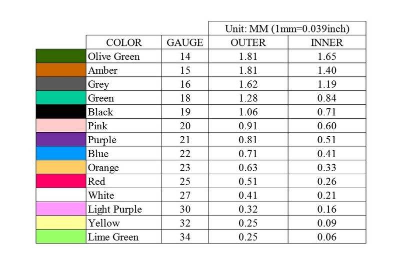

The viscosity of the resin is around ~930 cP, or ~0.93 Pa*s. I'm still shopping around for which syringe I'll be using, but most of them are 2-3 cm long, and the gauge can be any standard needle gauge:
Based on the numbers I've plugged in so far, it seems unlikely that anything over 18ga will work.

The viscosity of the resin is around ~930 cP, or ~0.93 Pa*s. I'm still shopping around for which syringe I'll be using, but most of them are 2-3 cm long, and the gauge can be any standard needle gauge: View attachment 292063
At 0.5 cc/sec, for 18 gauge, the shear rate at the wall will be 8600 sec^-1, and the shear stress at the wall will be 80000 dynes/cm^2. So the pressure drop for a 2 cm long needle will be ##7.6\times 10^6\ dynes/cm^2=760000\ Pa=7.6\ bars##. That seems like a pretty high pressure. For a 1 cm^2 piston, that would give a force of 76 N (if I did the math correctly).
