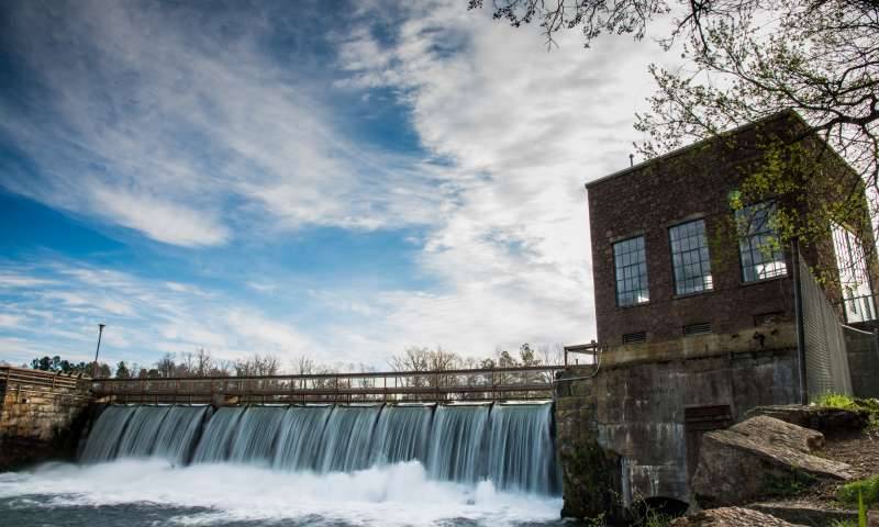

If you pass this way
there's a quaint little 1910-ish 400kw Westinghouse low head hydro plant that ran until 1970's. Now it's part of the state park at Mammoth Spring.
Has an early Woodward governor.
good trout fishing in that spring fed stream .
old jim
Likes Klystron, Fisherman199, anorlunda and 1 other person
