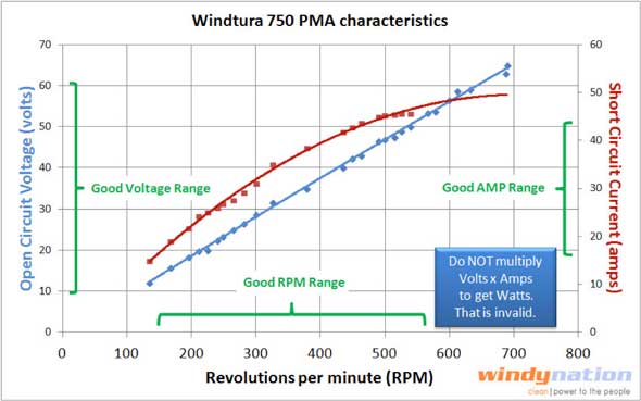

What would happen to a dc small generator if it is moved at more rpm that is it designed to? Does it will produce more, less or the same? I have this question since I while. Thank you
There are several types of DC generators, but do you mean something like this?
Open circuit and short circuit are load extremes. For intermediate cases, voltage and current depend on the load.
Yes something like that. So for example if it’s produce 12 at 2,000 rpm at 4,000 rpm can produce more the same but not less? Right?
You don't say 12 what, but in general, yes. At least until something breaks.
Some quantities like power may peak at a max, then start going down as RPM increases more.

So if I increase rpm in a certain point it will decrease power output?
Yes.I know you're trying to make a DIY hydro project. Why are you asking about higher than design RPM?

Bottom line, you can't analyze the generator by itself. It is generator plus load that determines performance.
