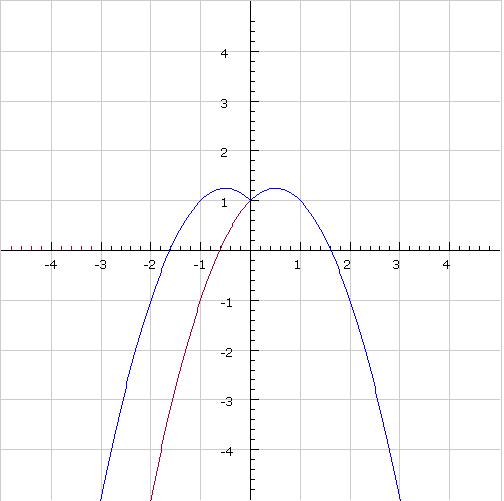

Graph on a grid with x from -4 to 4 and y from -4 to 4. A blue curve, an inverted parabola with a peak near y = 1.25, and a red curve, a steeper inverted parabola-like branch passing through (0, 1), are plotted.
The blue curve is [tex]|x| - (x^2-1)[/tex] and the red curve is [tex]x - (x^2-1)[/tex] (they overlap).
Because x is modulus it has a vertex with the x component of [tex]\pm \frac{1}{2}[/tex].
I also find that
[tex]\int_{-1}^{1} -x^2+x+1 \delta x = \frac{4}{3}[/tex]
I believe this is the reason your answers were out by 1 square unit. The modulus of x was not correctly integrated. But honestly I don't know.
