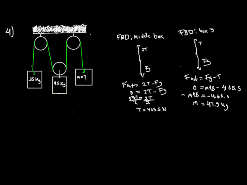

Question Summarized:
The box in the middle is remains motionless; how much mass was placed in box 3?
box 1: 35kg
middle box: 95 kg
box 3: ? kg
Attempt at the problem:
It would be easier for us if you typed your attempt here.
Check your answer with a calculation for the left mass. Do you see a problem?
The problem statement says the middle mass remains motionless, this does not have to be true for the other masses.

you should consider that boxes 1 and 3 might not be at rest.
