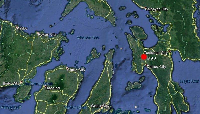

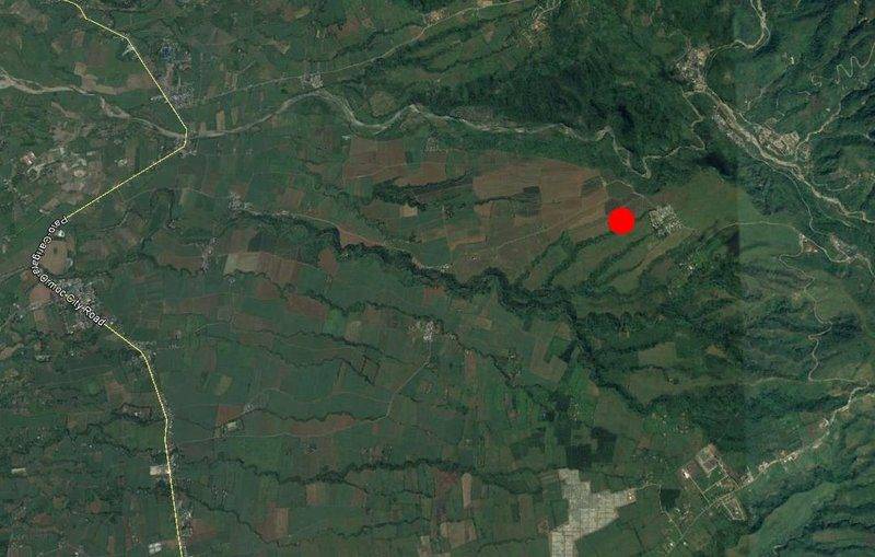

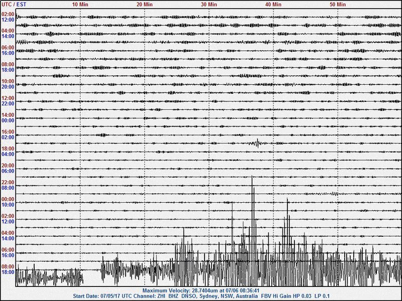

The seismic waves have finally started to fade away after todays M6.5 quake in the Philippines
Centred in the northern part of the island of Leyte
M 6.5 - 3km NNE of Masarayao, Philippines
Time: 2017-07-06 08:03:57 (UTC)
Location: 11.114°N 124.633°E
Depth: 6.5 km
regional location map ...
zoomed in ...
cheers
