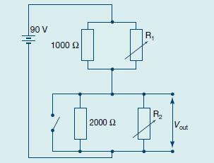

The circuit below combines variable resistors R1 and R2 with fixed resistors to make a complex voltage divider.
If the switch is closed and R1=8000ohms and R2 is 5000ohms, what is the output voltage.
V=IR
the equivalent resistor of 1000 and 8000 is 3077 and the current through that is 0.03A. I am not sure what to do after that.
  • Circuit schematic of a complex voltage divider: a 90 V source feeds a top branch with a 1000 Ω fixed resistor in parallel with variable resistor R1, then a lower section with a switch in series with a 2000 Ω fixed resistor in parallel with variable resistor R2, with Vout taken across R2.

You do not need to know the resistor values. Look at the diagram and think about it.
um..a current goes through the first parallel part and then splits up when entering the next parallel part...
is it 0 because the current will go through the part of the circuit where there's the least resistance?
Yes. All the current will go through the closed switch and none of it through the two resistances that are parallel with it.
The output voltage is I_switch * R_switch and R_switch = 0.
Although it's not relevant for the answer, the equivalent resistance of 1000 ohm and
8000 ohm resistances in parallel is not 3077 ohm. The equivalent resistance of 2 parallel resistances should be smaller then the smallest of the resistances.
okay thnx, my mistake the equivalent resistor should be 889ohms. Question, why does the current only go through the switch? Is it because its the easiest path?
