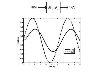

Given w =1, What is phiG ? Is it the phase difference between the two waves? If it is, isn't it simply phiG = (delta t/T)*360 but I am not getting the right answer.
PhiG = (0.5/2pi)*360 = 28.6
Also I don't know where this wt + phi = 2pi equation comes from.
The period appears to be about 6.3 s
The diagram is drawn wierdly. The waveforms appear to have a fixed phase difference everywhere except near t = 0 where one has been deliberately distorted to force it through the point (0,0). That origin region would be best ignored, it is so wrong.
There is also a +/- sign associated with the phase difference, according to whether the system introduces a lead or lag, respectively.
