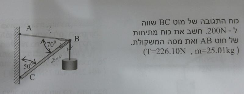

1. Homework Statement
I have to calculate the tension of AB beam and the mass.
The force of beam BC is 200N
2. Homework Equations
My work
T=226.10
M=25.01
Please write out your horizontal and vertical force balances on point B and your moment balance about point C.
Sorry but I'm not understand you
Looks like angle of vector BC is 40 degrees above horizontal, its magnitude is 200 N (pointing toward upper right), and it is equal and oposite to the vector sum of the weight and the tension force supplied by cable AC.
You're on a good way because you just simplified the problem in 2-D; then sum the x-components of the system and the y-components of the system by using trigonometry function and these two equations need to be equal to zero. Then that will become more simplier, and then you can find the answer.
Think about it as a truss with a single triangle. Now you can use the method of moments, the method of joints, or a free body diagram method. All are available on the web and aren't difficult.
