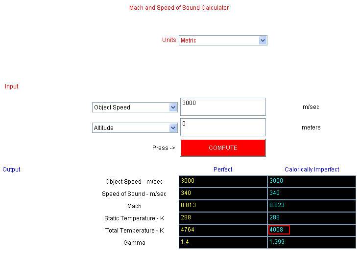

Imagine that some object (a long rod for example) is flying in atmosphere very quickly. If we know its speed, altitude and also amount of time spent during flight-can we calculate the amount of heat emitted during this quick motion (due to atmospheric drag)? I would like to know if that object is melted/boiled or no :smile: the temperature can be calculated by means of this online-calculator here: http://www.grc.nasa.gov/WWW/BGH/stagtmp.html Now, how the emitted heat should be calculated? The temperature should be multiplied to time? And should we compare the received result to materials heat capacity? :rolleyes:

So, how these q and h can be calculated? Imagine that we have got long rod with following parameters-1000 m length, 1 m radius. The surface area of such cylinder would b:
A = 2πr2 + 2πrh = 2πr(r + h).
A = 2*3.14*r2 + 2*3.14*r*1000 =6.28+6280= 6286.28 square meters
As for temperature, let’s rod’s speed be 3000 m/sec and altitude 0 meters (sea level), as we these at this site http://www.grc.nasa.gov/WWW/BGH/stagtmp.html the Total temperature of calorically imperfect gas (this should be takes, right?) is 4008 K, then what? :smile:
I have attached an excerpt from the 10th edition "Heat Transfer" textbook by J.P. Holman. This is what I would use to estimate the heat generated by supersonic flow. The calculator will save you some time in determining the temperatures you will need to use. See if this helps.
