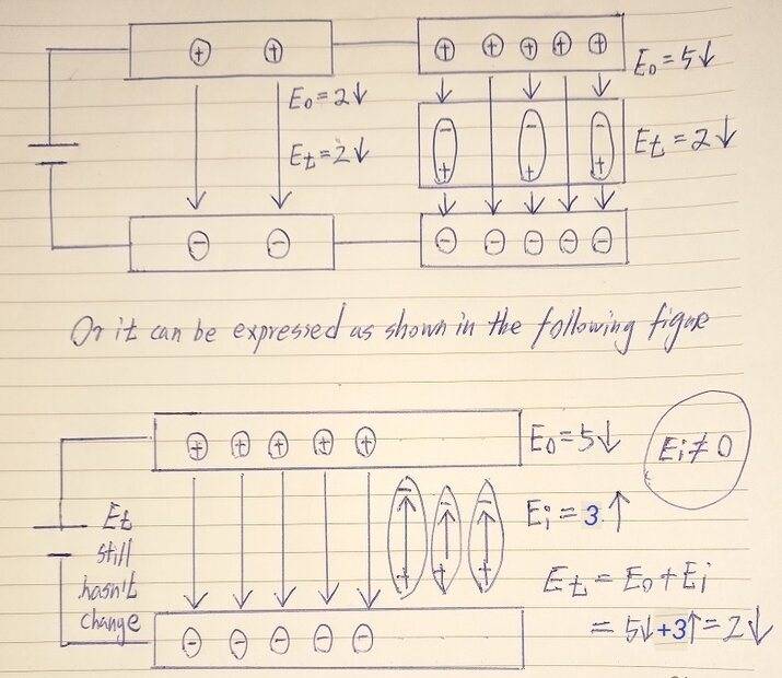

So, one more time:
In absence of dielectric, you have only the field of free charges: E1=V/d
With dielectric you have the field of the free charges (which is not E1 but a larger value, E1') and the field of the dielectric, Ed.
The total field in the case with dielectric is ##\vec{E}_2 = \vec{E}_1'+\vec{E}_d## where the directions of the two vectors on the right hand side are opposite so you actualy subtract the magnitudes.
None of the magnitudes E1, E2, E1' or Ed is zero.
But because the capacitor is connected to the same battery we have E1=E2=V/d where V is the potential difference provided by the battery and d is the distance between the plates of the capacitor.

@annamal
I'm getting more and more confused.
I think the crux of the problem is that you should think about interpreting ##E_0## as the electric field created by the free charge on the capacitor plate ##Q_0##, not the electric field of a capacitor without a dielectric.
Doing so makes the equation ##E_{total} = E_0 + E_i~## reasonable and universally applicable, including different cases with and without batteries connected, etc.
Simply put, it is ##E_{total}## = ##E_0## (generated by free charge on the capacitor plate) + ##E_i## (generated by induced charge on the dielectric surface).
This may help reduce misunderstandings and promote consensus.

Why would Ed equal to zero? Are you actually reading the posts or just the last line? I just said that E1, E1', E2 and Ed are all non-zero. How do you draw the conclusion that Ed is zero? The fact that E1=E2 implies that E1 =E1'-Ed (in terms of magnitudes).As E1 is not the same as E1' there is no way to conclude that Ed is zero.annamal said:Ok in the last part you say E1=E2=V/d, since ##\vec{E}_2 = \vec{E}_1'+\vec{E}_d##, would ##\vec{E}_d = 0##?

@annamal You seem to mention several times that ##E_i## generated by the induced charge ##Q_i## on the surfaces of the dielectric becomes zero, but ##E_i## is not equal to zero in the presence of a dielectric. Maybe the following diagram can help you understand.
In this example, the relative permittivity ##(\epsilon_r)~##is clearly equal to ##\frac {E_0} {E_t}=\frac{Q_0}{Q_t}=\frac {5}{2}=2.5##
