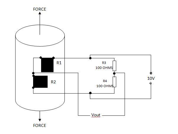

hi all, could you possibly help me with this problem?
R1 and R2 are 2 guages with resistance of 100 ohm.
A steel bar has diameter 45mm and modulus of steel bar is 170GN/m^2 and gauge factor of 2. How would I calculate Vout when a load of 35kN is applied?
i know what the Vout formula is and stress = tensile strain x YM.
thanks
