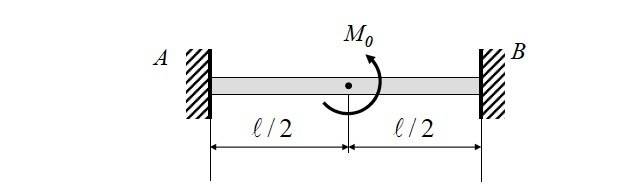

The picture of the beam below has a module of rigidity EI, determine the reactions at the supports and the equation of the deflection curve of the left half of the beam
v*EI=((Ma*x2)/2)+((Ra*x3)/6)
Ʃ of Forces in Y direction = Ra+Rb=0
Ʃ Moments about A = Ma-Mo+Mb-Ra*L
How do I go about finding Ra and Rb and Ma and Mb?
For the left had side of the beam the bending moment equation is Ma+Ra*x
Putting x = L/2 into the defelction equation gives me:
((Ma*L^2)/(8EI))=((-Ra*L^3)/(48EI))
Where's your picture of the beam?
Sorry I forgot to add the picture. It should be attached now.
The beam is statically indeterminate. You'll need to use double integration of the bending moment curve and the boundary conditions at the ends of the beam to solve for the reactions and moments at the ends.
