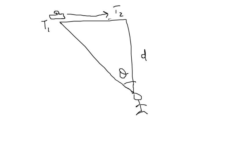

will it look like this?
  • Hand-drawn sketch of a right triangle with a small boat at the upper left labelled T1, an arrow pointing right to a point labelled T2, a small boat and a figure on a dock at the bottom right, and the side from the dock to T2 labelled d.
Yes. You could measure on the other side of the perpendicular too until the car gets out of sight. Do you know how to use trigonometry to figure out how far the car goes while it is in sight and you are timing it?

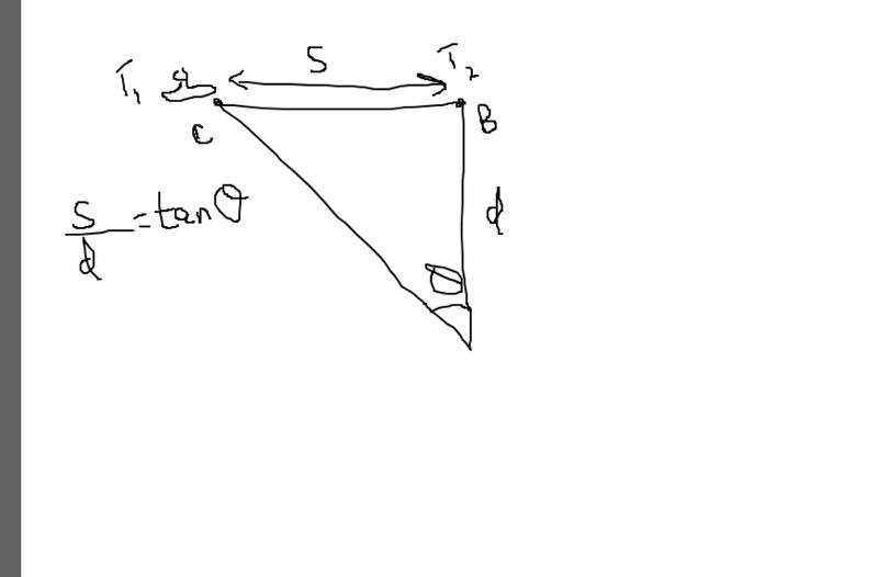

yeah, I can use the trigonometry but for that other side, I need an angle. I am confused about that angle. part. For the time I will start with 0s and till the time I can see it.
  • Handwritten diagram of a right triangle with a horizontal side labelled s between points A and B, vertical side labelled d, and angle theta at the bottom vertex; labels T1 and T2 appear above the ends of s, and the equation s/d = tan theta is written at left.
I would do it with two angles. The angle ##\theta## you have drawn for the car approaching the perpendicular and another angle ##\alpha## on the other side of the perpendicular as the car leaves the perpendicular. Those angles aren't zero. They are what you are going to measure so they are known.

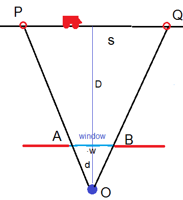

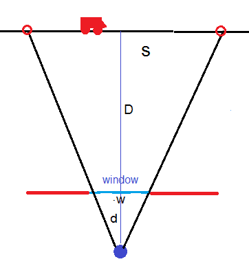

You do not need to measure angles . Measure the distance between the road and the wall, D. Stand at a distance d from the window of your room. Measure the width of the window: w. Measure the time you see the car passing in front of the window. The triangles shown are similar, so you can calculate the distance s the car travels from the measured data: D, d, and w.
Diagram of similar triangles: a horizontal road at the top with a car, a blue observer point at the bottom, a window segment labelled w, and distances labelled D, d and s.
  • Diagram of similar triangles: a horizontal road at the top with a car, a blue observer point at the bottom, a window segment labelled w, and distances labelled D, d and s.
LCKurtz said:
@ehild: Aren't you assuming the building and window are parallel to the road?
Yes, I assume. It is quite common, that the buildings are parallel to the road isn't it?
Otherwise the problem would be tricky to measure angles. And the distance of the road from the building would not be constant along the route of the car.
i am confused that how D,d,w can help us calculate s
Geometry diagram: horizontal line with points P and Q at its ends and a red vehicle on it, lines from P and Q meet at O below, with a horizontal segment AB marked as a window, labelled s, w, D and d.
The AOB triangle is similar to POQ triangle. What is the ratio s/w in terms of d and D?

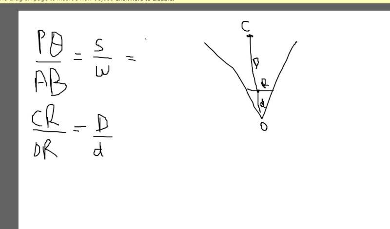

  • Handwritten proportion equations: PQ/AB = s/w = and CR/OR = D/d, beside a diagram of a V-shaped figure with apex O, point C above, a horizontal segment R, and labeled angle theta and distances D and d.
robin123 said:
Sides are proportional
Which sides are proportional?

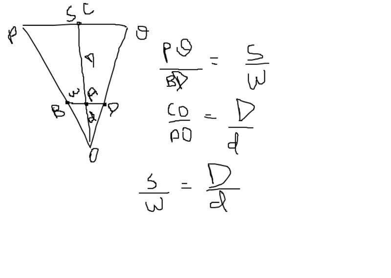

  • Handwritten geometry sketch of a triangle P, Q, O with a horizontal segment BD and a vertical line from C to O, labelled S, C, A, d, w, D, with ratio equations PQ/BD = S/w, CO/PO = D/d and S/w = D/d written beside it.
Sorry, I can not read your writing.
S is the length taken by the car. It is the base of the big triangle.
W is the width of the window, it is the base of the small triangle.
D is the distance of the road from the wall. (Measured)
d is your distance from the wall inside the building (also measured) .
The height of the small triangle is d.
What is the height of the big triangle?
The ratio of heights of the triangles is the same as the ratio of the bases. So what is s/w in terms of d and D?
