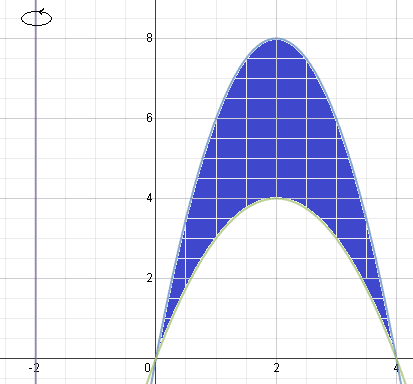

For the third one, I just used the cylindrical shells method with (2+x) as the radius, expanded the integral, and integrated. I got ~268.083 as the answer.

Let's look at the third one...you gave your answer and $r$, but I don't really know what you did, so let's step through it and check your result.
I would begin by plotting the region to be revolved and the axis of rotation:
Now, the volume of an arbitrary shell is:
$$dV=2\pi rh\,dx$$
Can you state $h$ as a function of $x$ and then state the volume of the arbitrary shell as a function of $x$ using $h(x)$ and $r(x)$? After that sum up the shells in a definite integral...what do you have up to that point?

So, to reiterate my response to the question, the radius would be 2+x, so that replaces the radius in the formula. Also, the greater function is subtracted by the function that is smaller over that interval in which they intersect. Ultimately, after integrating, wouldn't that end up giving me ~268.1?
Well, your answer is correct to 1 decimal place, but can you show the integral you used, your work and the exact answer? :D
