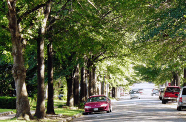

A traditional neighborhood may still have overhead power lines.
Tree-lined residential street in daylight, with mature trees forming a canopy over the road and parked cars along the curb, one red car in the foreground.

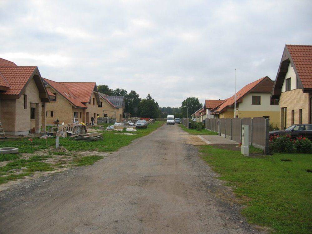

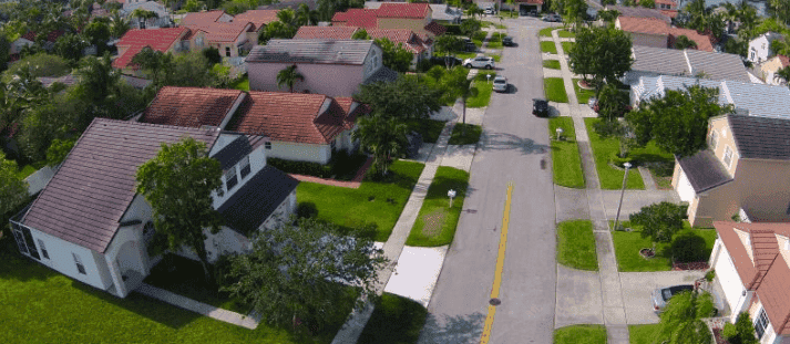

Most modern neighborhoods have underground utilities.
Aerial view of a residential street lined with single-story houses with tile roofs, green lawns and mature trees; no overhead power lines are visible along the street.

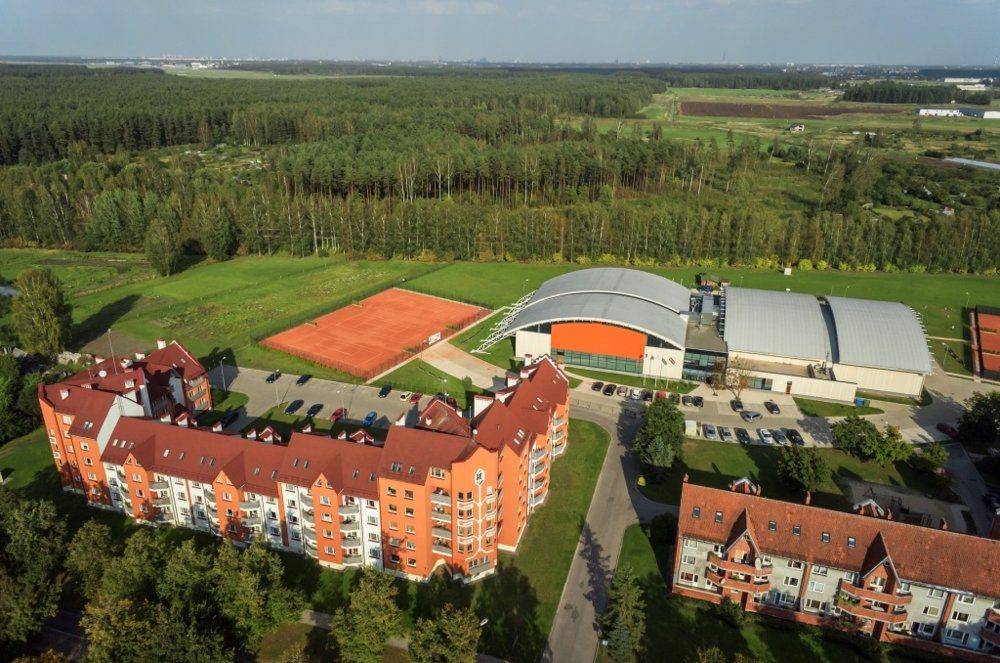

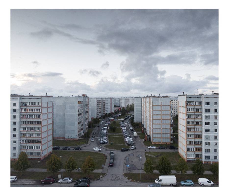

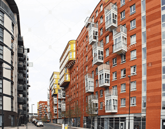

High density. Almost always underground.
Street lined with multi-storey apartment buildings: red brick block on the right with white-framed balconies, and a cream and dark-balconied building on the left, with a yellow-fronted block further along.

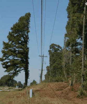

Utility tree trimming around distribution lines. The locals protest if the trees are clear cut instead of trimmed.
Overhead power line running up a grassy embankment beside a road, with a tall pine tree leaning on the left and dense trees on the right under a clear blue sky.

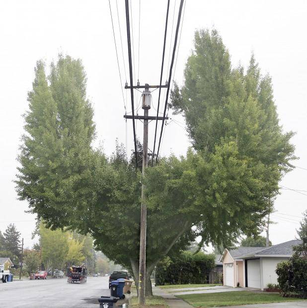

Yeah. It's ridiculous how we deal with trees:
Street photo of a wooden utility pole with a transformer and several overhead power lines running directly above a large leafy tree that has grown up around the lines; houses, parked cars and garbage bins line the road.
This happens to be Califonria, but it's like this everywhere in the US. A few things to note:
-This has to be trimmed yearly.
-Clearly, if these power lines fall, they can go nowhere else but into the tree.
-The tree is *directly below* the power line. Which came first doesn't even matter: we should not have trees planted directly below power lines.
Removing/avoiding trees below or within a certain distance of power lines would be an easy way to both save money and improve reliability.

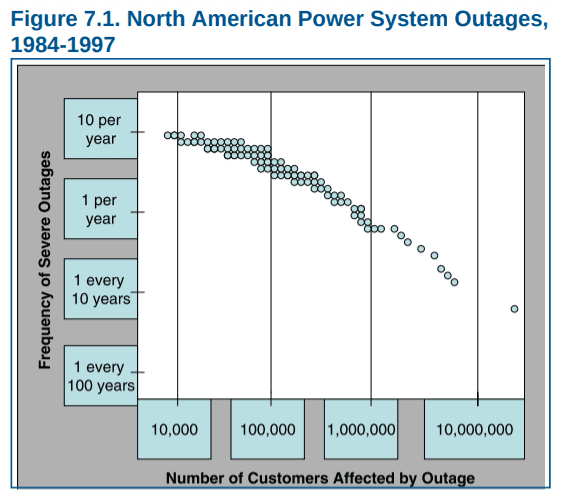

The first link includes only blackouts affecting 1 million or more people; thus transmission. But most complaints come from chronic distribution problems, that may effect only a few hundred people per incident, but many more incidents. Even the following curve cuts off at 10000 customers.
Scatter plot titled North American Power System Outages, 1984-1997: frequency of severe outages (10 per year to 1 every 100 years, y-axis) against number of customers affected (10,000 to 10,000,000, x-axis), with points forming a downward-sloping band.
That data is consistent with the part I am most familiar with: New York City, Manhattan Island, blacked out in 1965, 1977, and 2003. 3 times in 38 years.
The second link you gave is closer to the problem because it is at the customer level, but the list seems to be limited to 3rd world countries. The link below comes closer. It has EU data (0.6 interruptions per business per year) but is is missing data for North America.

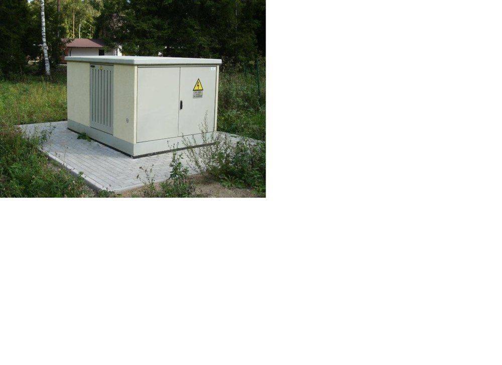

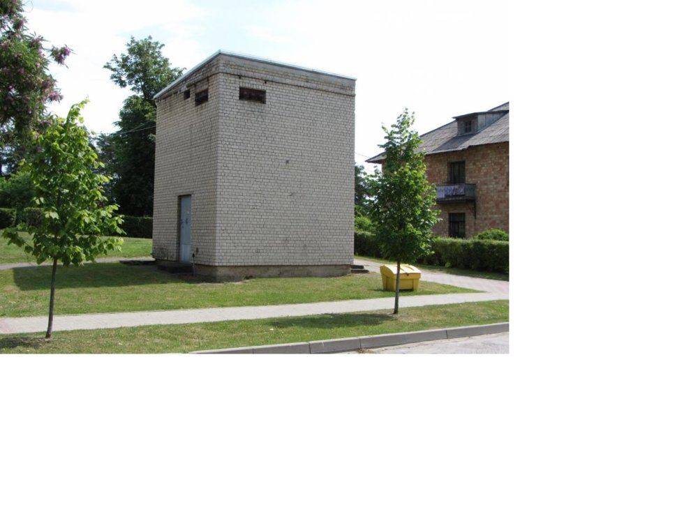

Well if anyone is interested , I live in Latvia, we are part of the EU for some time now , formerly USSR. Most of our electrical infrastructure is from the USSR and lots of (mostly transmission/distribution) have been changed over the years and upgraded. We have the luxury of being in a modest climate with average temperatures and very rare occasions of severe weather, (which tend to shift towards a more frequent weather anomalies due to climate change, this I can report with certainty from my own experience) Our grid is mostly 330kV lines with step down to 110kV for smaller cities and 20kV for inner city and rural areas, then the distribution is then 20kV to 0.4kV or 400v 3 phase with 230 volt single phase , in other words just as in most other EU and Russia. Currently we are interconnected with Lithuania (where HBO Chernobyl was filmed) and on the north with Estonia which is then connected with Scandinavia. Most of our power comes from 3 medium sized Hydro plants located o0n a single and very predictable and stable river, not counting local circuit breaks and small tree falls on local 20Kv lines we haven't had a blackout (major one that affects more than half the country with a population of 2 million) for more than 10 years.
The last one happened in 2005 after a severe storm ,since then they cleared most trees and now they built a new 330Kv line in my region so this has been made even less of a possibility.
I can say that it seems Hydro is among the most reliable power sources for electricity, our plants haven't had an accident since they were opened and everything that is done is routine inspection and upgrade.I also have to agree with @russ_watters and @anorlunda, I too think that if people choose to live in places where the climate is severe they also have to keep in mind that these places come with a cost just like for rich people hiring bodyguards is a thing. In our country also some very rich people live right next to the sea in lavish houses , some of which are literally meters away from water but nobody gives a damn when they get flooded or lose electricity because there is plenty of nice land to live on yet when one goes over his way to pay billing fees and arrange a house next to sea one also has to take into account the risks involved.

In this region (NE US), by far the number one cause of power outages is trees, mostly coming in contact with distribution lines along the streets during wind or snow/ice events. As opposed to transmission corridors, trees in residents front yard are not feasibly removed. A compromise in lieu of expensive undergrounding is to use insulated tree wire , wire with enough insulation over it to prevent line tripouts during tree/branch contacts. But this is also an expensive task, and its use is not common in many instances. Trees were the problem 50 years ago, and are still the problem now. At least in this region.
