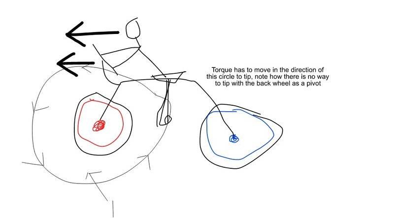

Ok, this is a question of torques. It is impossible that if you are moving forwards with significant speed, if you apply the rear brake that you would tip.
Let's examine the situation when you apply the front break. You are a cyclist with constant velocity and your front wheel automatically becomes a pivot point. In order for you to tip it over, there needs to be significant torque counterclockwise relative to the pivot point in order for the bicycle to tip. This torque is generated by your entire bike's and body's constant velocity. Mostly your upper body since that torque is directly in the direction you need to make the bike tip.
If you make the back wheel as the pivot, there is absolutely no way for the bike to tip. You could try some stuff like you said. Try and lean forward, but then again that is not pivoting around the rear wheel, but the front. See the attached image.

Your description is correct, and easily verified by some experiments. For grins and giggles and because this is a physics forum, you could make a free body diagram, then work on the equations that prove it.

If I only use the rear brakes, is it even possible to tip the bike over?
Theoretically yes. The rear brake force disappears quickly, but it does apply some angular momentum to the bike. Whether that angular momentum is enough to tip the bike, depends on how high the center of mass is compared to its horizontal distance to the front axle.
I think I understand what OP is saying. If the rear wheel is big enough and the center of mass is high enough, you could use the angular momentum to tip it over. I was only thinking in terms of linear momentum.
Yes, but even when you neglect angular momentum of the wheels, it is theoretically possible to tip it over forward. Consider the torques around the center of mass of bike & rider.
The braking force applies an angular impulse to the bike & rider as a whole, which depends on the distance between center of mass and ground. After the back wheel lifts off, the frontal normal force transfers opposite angular momentum, which depends horizontal distance between center of mass and front wheel contact. You can theoretically adjust those two distances, such that the initial angular momentum is not completely canceled by the front wheel counter torque.
