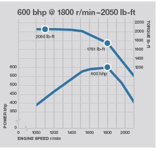

Another piece of this that you may need to consider. Stayed rather simplfied so to allow you to explain in similar fashion. Hp is a measure of work performed over time, torque is a measure of potential work.
In the case of the truck. The diesel engine involved has a very limited rpm range all being in the low end. The gas engine has a very wise range. If one counts only the potential (with no allowance for time) the truck engine is far stronger. Also the low speeds involved give tremendous life cycle.
At the same rpm the gas engine will have no comparison to the diesel. However, when the gas engine is turning more than 5 times the rpm it can actually be producing more Hp (near consistent torque at radically greater cycles per second ). The downside is that the high rpm give limited duty cycle.
Concider if you would your mack truck alongside a formulae Atlantic engine the 255 ft/lb 1.4 L is no comparison to the (probably) 10L or so diesel at the bottom end. However by the time the mack is wound tight at approx 2000 rpm and the car is at 12,000 up tight the truck looses. But, what happens to the drive components when you clutch and shift at that rpm against an 80,000 lb load?
The truck is a much better choice for starting, stopping, and everyday life. The high rpm has engine is more effective at high speed and controllable application of power to the ground.

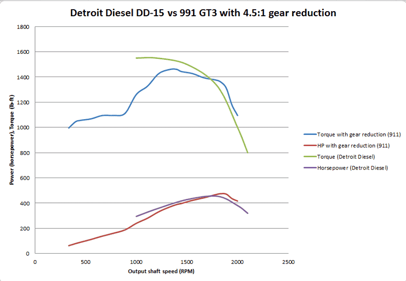

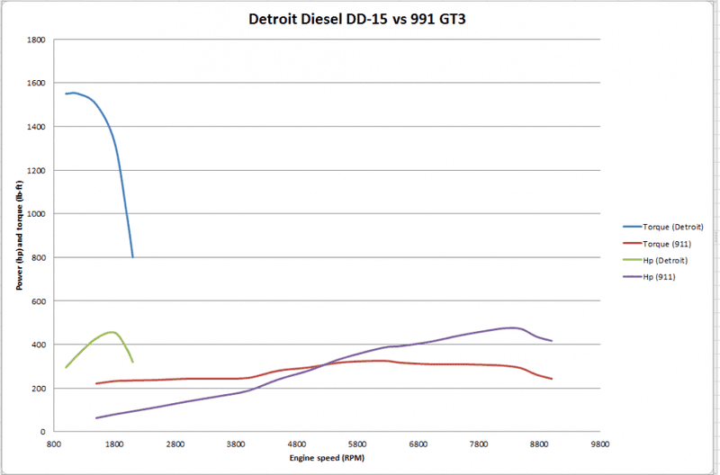

Unfortunately, this is an area where the intuition of a lot of car and truck people leads them astray. Power tells you the rate at which you can add energy to a system, so for the same horsepower, on a vehicle with the same losses, weight, and aero, you will get the same acceleration. Let's look at an example. Let's compare a high performance car engine to a truck engine. First, we'll look at the Porsche 991 (current generation 911) GT3 engine, which makes 475 horsepower at a fairly outrageous 8250rpm, redlines at 9000rpm, and only makes 325 pound feet of torque at about 6250rpm. Second, we'll look at the Detroit Diesel DD15. Specifically, we'll look at one rated for 455 horsepower at 1800RPM, and 1550 pound feet of torque at 1100rpm. Now, if you plot both of these on the same axes, it looks rather silly, and the Detroit is way, way better at making a ton of power and torque at low RPM, which is what we want for hauling a load, right?
However, let's keep going with this analysis, just for fun. Suppose we keep everything the same except we put a 4.5:1 reduction gear on the GT3 engine, so that when the engine is spinning 9000RPM, the output shaft of this reduction gear is spinning 2000RPM. This will also multiply our torque by a factor of 4.5. Now, if we compare the output of this gear reduction to the output of the detroit diesel, this is what we get...
With this gear reduction, we suddenly have a small (3.8 liter), high performance gas engine that is spinning an output shaft with a thousand pound feet of torque at 500RPM, and over 1400lb-ft at 1500RPM. This is very comparable to our truck engine, and you would likely get similar acceleration from 1200-2000RPM (output shaft speed) with both of these engines hooked to the same transmission and drivetrain (aside from the gear reduction), despite the fact that one of them is a high-strung, titanium and aluminum 3.8L flat 6, and the other is a large, turbocharged, 14.8L diesel inline 6. The diesel will likely last much longer of course, and get significantly better fuel mileage, but purely from a performance standpoint, horsepower really is all that matters.

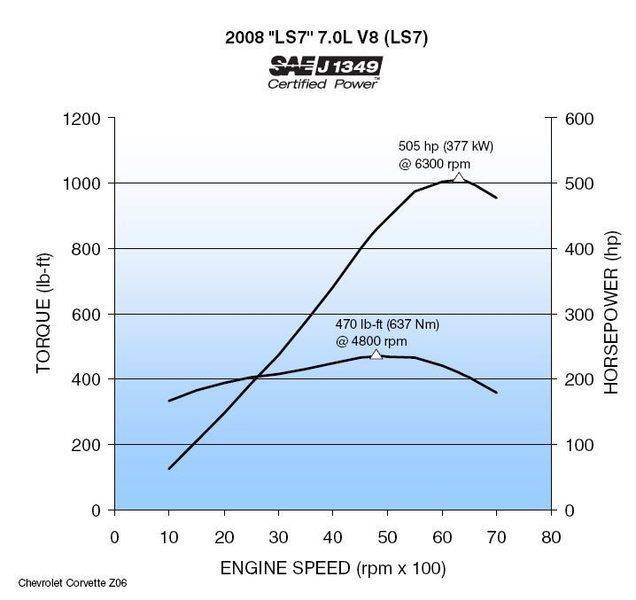

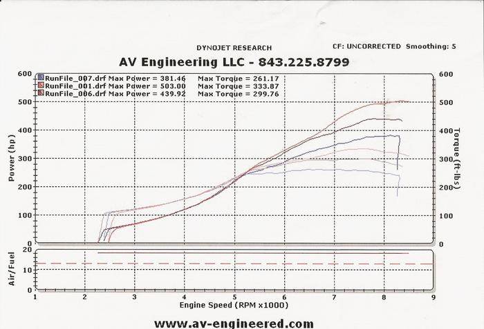

Just because the people who build drag motors have a misconception doesn't make them right. Did you even read my last post?
While googling torque curves and such to use for the example in my last post, I came across a great analogy for this argument. This is like a bunch of people arguing about water tanks, where one group says that the volume of the tank determines how much water it can hold, while another group says the height of the tank is most important. Yes, all other factors being equal, the taller tank holds more water, but at the end of the day, the volume is a direct measure of how much it can hold, and you can achieve that with a tall skinny tank or a short squat tank. Similarly, you do need some torque to make horsepower, and all else equal, more torque equals more power, but at the end of the day, the acceleration, the work the engine can do, or the weight you can tow is determined by the horsepower, and you can achieve that with a high revving low torque engine or a high torque low revving engine.

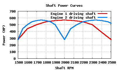

What you are not seeing is that you need to compare power curves and not peak power alone. Nobody here is saying that engine builders don't know how to build engines. It's just that a lot of them don't use the right terminology when they express themselves.
Moretorque said:
Here is something else, the guy's on the PU truck forums who bought a 300 HP diesel to replace their 300 HP gas motor say the diesel pulls night and day better way more powerful at building speed under load.
Yes, but you are comparing maximum horsepower only. Are both power curve alike? Meaning does the diesel engine makes more power at a lower rpm than the gas engine? Usually, diesel engines have the advantage in the lower-end:

h The problem is you can't keep your motor peaked at 9000 RPM, peak output Torque MPH is the same but only peak. It is your ability to maintain it and build it when you shift and when your RPM drop you do not have the torque coming out of the engine shaft to maintain the power when the revs go down shifting and pulling 40 tons you cannot build them back up under that load.
That's why I showed you the torque curve comparison with the motor geared down 4.5:1. It makes about the same torque at all output shaft RPMs, and it's making over a thousand pound feet starting at 500rpm output shaft speed (2250RPM engine speed), and over 1400 pound feet at 1200RPM shaft speed. You would set it up with a transmission so that it would engage the clutch at ~1000-1200RPM shaft speed, and on each shift, you'd drop back down to about 1300 from 1800 or so. This would keep you very solidly in the power band. If you look at the torque curve again (https://www.physicsforums.com/attachments/dd-15-vs-991-gt3-2-png.84241/), you'll see that the GT3 motor makes comparable torque to the Detroit Diesel from a shaft speed of about 1200 to about 2000 RPM (5400 to 9000 RPM motor speed), and from about 1750 RPM to 2000 RPM (7875 to 9000 RPM motor speed), it's actually making more torque (and power) than the Detroit. Given both of these torque curves, why would you not expect the GT3 engine to be able to tow? Hell - even at 400RPM shaft speed, it's making 1000 pound feet of torque, which is easily more than the 238hp Mack that you keep talking about would make at any speed, and this is just at 400RPM!

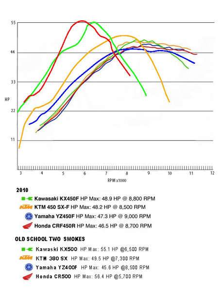

Note that in the virtually unlimited class for tractor pull contests, high power, high rpm engines running on mostly nitro-methane and some alcohol are used, not diesel engines. These engines have to be rebuilt after nearly every run, similar to a top fuel dragster, so they aren't practical, but it does show that power and not torque matters.
In some cases, it's the torque versus rpm curve that matters. Some gasoline engines have nearly flat torque curves. I have a 2001 Suzuki Hayabusa motorcycle with a 1.3 liter engine that redlines at 11000 rpm. The engine makes peak torque at 8500 rpm, but makes 80+% of peak torque from 3500 rpm to 10500 rpm, which is a fairly flat torque curve.

No, it really isn't 100% correct, and I already showed this a bunch of times. Diesels really don't have exceptionally wide powerbands, and if you set up a gas engine properly, it will easily tow everything the diesel will with the same horsepower. In fact, most large diesels have much narrower powerbands than gas engines do - they only work over about a factor of 2 in RPM (1000-2000), while most gas engines provide good torque over a factor of 3 or more (2000-6000 or so). If geared correctly, a 500hp gas engine will very easily pull a semi. For a really extreme example, look at the Chevrolet LS7:
This engine makes about 350 lb-ft of torque at 1000RPM, up to a 470lb-ft peak at 4800RPM, and it's still making about 350lb-ft at 7000RPM. This means it's making 75% of peak torque or more across a factor of 7 in RPM. This is much better than the GT3 engine I picked before, because I intentionally chose a very peaky engine with a narrow powerband last time to prove the point that it could still haul a load just fine. Now let's look at another Detroit Diesel, similar to the one I was talking about before (but a bit more powerful):
This engine makes 75% of peak torque or more from 1000 to about 1900RPM. This isn't even a factor of 2. This is also why modern trucks have so many gears - the diesels need them because their RPM range is much narrower than for a gas engine.

  • #57
@cjl
I tried to read between the lines with @Moretorque to understand what he means and what he's referring to, rather than analyze every single word he said.
What I think he's referring to is the small highly-boosted engines vs large displacement engines. It's not really about diesel vs gas. Your Corvette engine is not a good reference in this case, as it can be considered as a truck engine fitted within a car (I mean 7.0L :wideeyed: ! C'mon, that is huge!). Here's a dyno sheet I retrieved from the web that is claimed to be from a 1999 Honda Civic with a turbocharged 1.8 L:
If you look at the run with 503 hp and 334 lb.ft, the 75% of peak torque rpm range is 5200-8500 rpm (a ratio of 1.6).
So from that point of view, he is right, even with your criteria (I personally prefer qualifying useful rpm range by the power curve rather than the torque curve, since engine torque is irrelevant to acceleration as you and I stated). With two engines with the same peak power, the one with the highest power in the lower rpms should accelerate faster (Even though he used the terminology «diesel» and «gas», I considered he meant a generalization for a «wide power band» vs «narrow power band»).
When he said that acceleration rate depends on torque, I know he's «grammatically» wrong, and that's why I pointed out that when people talk about «maximum torque», they actually - indirectly - refer to «low-rpm power» (Whether they understand it or not). So from that point of view, he (and engine builders) is still technically right.
But concerning a 238 hp engine that will pull a load as well as a 2500 hp engine or a that a 300 hp engine that will stall while pulling a large load, no matter the gearing, I admit, these are wrong. But at this point, I think @Moretorque was on the defensive and this is stuff that is obviously made up and not based on actual facts. So I prefer to calm everything down and focus on what is right, assuming the best of intentions from everyone.
Sometimes we have to use baby steps to get where we want to go. Otherwise everybody is just arguing in a cacophony and we all stand still.

More Torque, It is great to have you visit the forum. Couple things to spread out the answer as I believe I have recognized an issue not previously addressed directly. As brought up before Hp = Hp there is not a way around that however there is some items that cloud our perceptions. Let me list several fictional or reasonably so motors and engines.
262.6 FtLb x 12,000 RPM HIgh performance racing gasoline engine = 600Hp
370.7 FtLb x 8,500 RPM High performance street gasoline engine = 600Hp
1,400.5 FtLb x 2250 RPM High power diesel engine = 600 Hp
1,750.7 FtLb x 1800 RPM Low rpm truck diesel engine = 600Hp
5,729.5 FtLb x 550 RPM Medium speed propulsion diesel engine = 600 Hp
1,800.7 FtLb x 1750 RPM Electric Motor = 600 Hp
21,008 FtLb x 150 RPM Steam turbine Marine main engine = 600 Hp
All of the above can do the same amount of work. However, in the real world the steam turbine will dominate. The Electric motor would be next in line. The diesel engines would be third in the order. Coming up the rear would be the gasoline motors. This is not due to the Hp. It is due to engineering concession and design practices. If you look at Design specs or even marketing catalogs you will notice the most significant difference when you look at industrial equipment. Anything with an electric motor is a lower rated motor than an equivalent gasoline or diesel. This is a due to how the ratings are applied and something called Duty cycle. Normally accepted correction factor is 3-5 Electric motor to Gas engine.
Electric motors and turbines are rated at a continuous rating ( the spot where they can maintain indefinitely). Internal combustion engines ( aside from gas turbine which I am intentionally not bringing into this) are rated at the peak output. Some of the motors have varying correlations to life but generally gasoline engines ( due to heat accumulation) can perform at approximately 75% for reasonable times and still see reduced life down to 25% of operation at peak. Diesels due to their better design in handling heat can operate for reasonable periods at 80% and see little change in life up to approximately 40% of operation at peak. Electric Motors can operate (as rated) at 100% of there rating full life and for short periods at above peak. Typically 115% is what they are capable of. Steam Turbines are also fully capable of running continuously at rated level. They can usually exceed this rating be 120% and sometimes more. The down side here is the parasitic losses due to all the associated equipment is high.
To accommodate these factor Design personal usually design with the companies proprietary correction factors. But the closer you get to the public the more those same companies pad the facts by reporting an inappropriate statistic.
Let's revisit those motors with more appropriate statistic;
High performance racing engine = produces 600 Hp peak, rated at 600 Hp, works as if it is approximately 540 Hp, design as big as the class allows, and dies very quickly
High performance street engine = produces 600 Hp peak, Rated at 600 Hp, works as if it is approximately 400 Hp, designed as whatever the customer wants, and requires frequent maintenance to keep it running.
High power diesel = produces 600 Hp peak, rated at 600 Hp, works as if it is approximately 480 Hp, designed as near 480 Hp and delivers long service cycles.
Low RPM truck diesel = produces 600 Hp peak, rated at 600 Hp, works as if it is approximately 500 Hp designed as near 480 Hp and delivers very long service cycles.
Medium speed propulsion Diesel = Produces close to 680 Hp peak, rated at 600 Hp, works as if it 600 Hp, designed as near 600 Hp, and delivers extremely long service cycles.
Electric motor = Produces close to 690 Hp peak, rated at 600 Hp, works as if it is 680 Hp, designed as near 600 Hp, delivers full rated life when used within rated duty cycle (even if cycle is greater then 100%)
Steam Turbine = produces close to 720 Hp peak, rated at 600 Hp, works as if it is 600 Hp, designed as near 600 Hp, delivers very long service cycles even when run occasionally at 20% above capacity.
You can see from this that there is a lot of hubris involved here. Some of it is justified and some of it is just game playing. If one could magically adjust all motors to be the same after rating/derating and just go by the numbers they all fall into Hp is all the same. but we would have to test only the momentary peak. Heck the blown nitro motors start to break in less than 1 sec. and by the end of every pass they need to be completely rebuilt. There is not an actual Dynamometer to see how much they produce. It is all just someone's best calculation.
