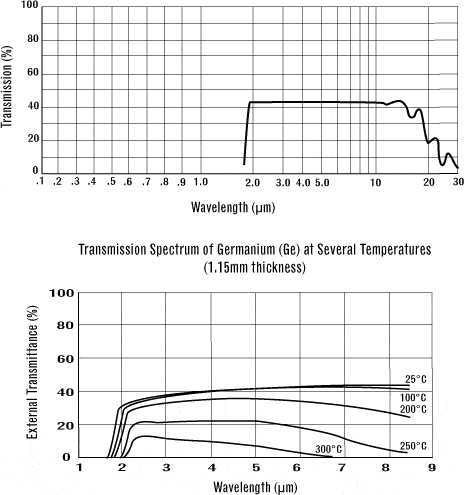

Germanium seems a good candidate, for a better view
http://rmico.com/technical-notes/bk7-quartz-ge-si
in particular
Two transmission plots: top, transmission (%) against wavelength (.1 to 30 μm) for a material with a flat plateau near 40% from about 2 to 10 μm; bottom, Germanium transmission spectrum at several temperatures (1.15 mm thickness), external transmittance (%) against wavelength (1 to 9 μm), with curves labelled 25°C, 100°C, 200°C, 250°C and 300°C.

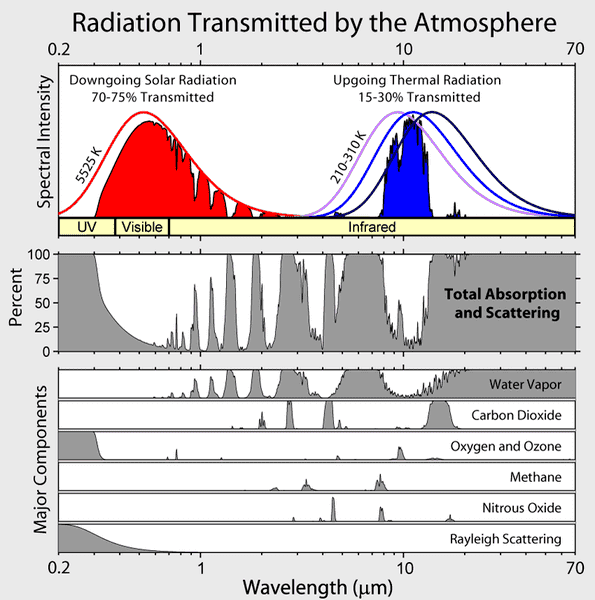

based on this calculator
http://www.calctool.org/CALC/phys/p_thermo/wien
peak radiance of a 300 K object is 10 μm
Chart titled Radiation Transmitted by the Atmosphere, plotting spectral intensity against wavelength from 0.2 to 70 µm; shows downgoing solar radiation peak at 5525 K, upgoing thermal radiation curves at 210 to 310 K, and total absorption and scattering percent, with major atmospheric components below.
there's some absorbance around that wavelength

Although, they don't quite cover the spectrum that would be optimal, the limit currently for commerical mirrors is up to 2500nm,This is usually layered dialectric coatings.
really want that to be transmissive between 2500nm and 15000nm.
Germanium does a good job, although the ROI would be terrible, silicon, which does about 1600-7000nm would be ok, though I am guessing cost wise it wouldn't be much better.
