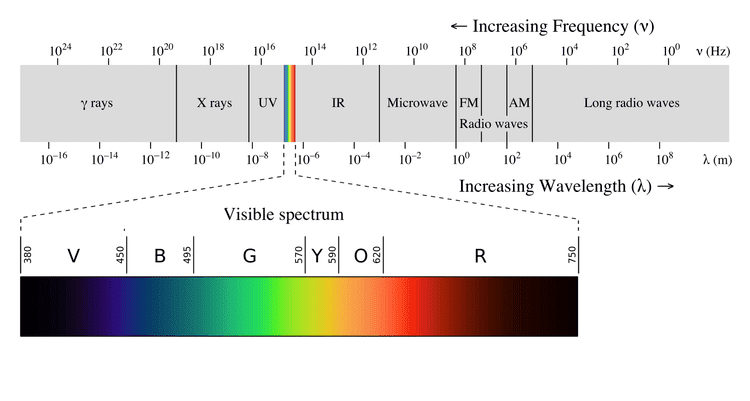

In what would be called "conventional" antenna, say, a dipole of tube, wire or PCB track, the frequency
isn't overly high, around 60 - 70 GHz. That is around the frequency used by collision avoidance radar
in cars etc.
From there and up into the 100's of GHz and low THz, the RF emission is usually generated within
semiconductor devices eg. special diodes and radiated out through the body of the diode.
This is a very long way below IR frequencies.
Once you get to IR, Visible Light and UV light. The generation process for EM changes and it has to
do with injecting energy into the atoms of a material, say, the tungsten filament if a light globe.
This causes some of the electrons in the atoms to jump to higher energy levels and when the electron
returns to its normal energy level, it emits a photon ( packet of energy) of light. The frequency of the
emitted photon is dependent on the energy level it has.

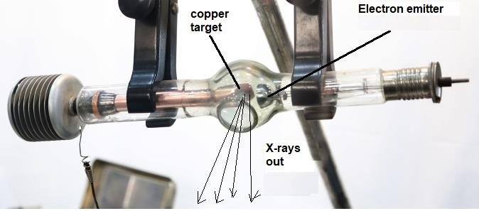

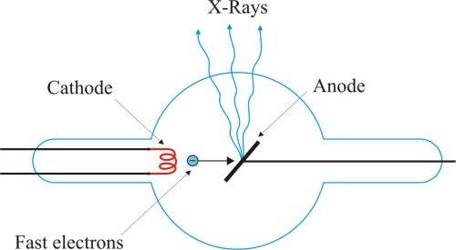

As we move up into X-rays the generation process changes yet again.
Basically, as @Drakkith said, one way X-rays are generated is to fire a beam of electrons at a target.
The target in medical X-ray machines is usually a piece of tungsten. The electrons in the beam are
accelerated to very high speeds using very high voltages.
X-rays are generated when the beam of electrons give up some of their energy when they interact with
the electrons surrounding the nucleus of the tungsten atom or from within the nucleus. This is called
Bremsstrahlung emission ( go google it and learn more).
Here's an old X-ray tube I photo'ed in a museum recently
see the similarities with the diagram above
the angled target etc
