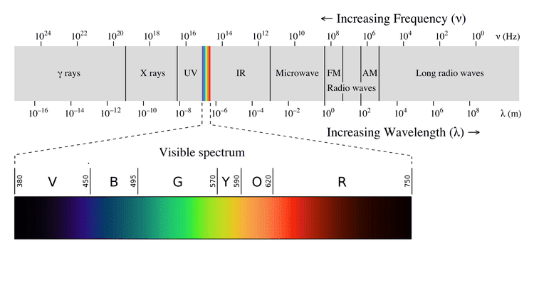

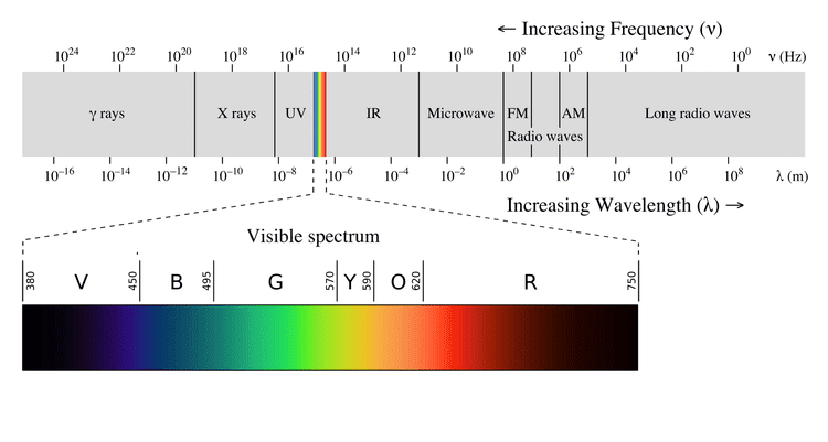

So this is the reason why visible light can't be emitted by antenna?
no exception?
View attachment 246298How about chest x-ray machine. How do they direct the x-ray? nuclear decay since antenna not possible?
Visible light can be received by fairly conventional antennas at the nano-scale so if we can't emit visible light from an antenna it's not because of a physics limitation on EM antenna dipole radiation at that wavelength.
https://www.me.gatech.edu/featured_colarectenna
