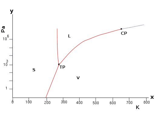

It's easier to explain with an image.
Phase diagram for water. At 1bar = 10^5 Pa, you have two transition temperatures. At 273K - melting, and 373K - boiling. At roughly 10 mbar = 10^3 Pa, there is a triple point (TP). At that point, liquid, solid, and gaseous phases can coexist. Bellow that pressure, there is only one transition temperature, from solid directly to gas. The liquid phase cannot exist, so there is no boiling.
