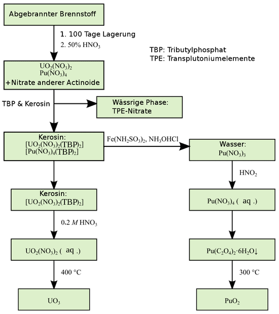

fresh_42 said:
the unsolved question of how to deal with the waste
This question is not unsolved in a technical sense: you just reprocess the waste. That is what France, for example, has been doing for decades.
In some countries, of which the US is one, political factors have prevented this obvious technical solution from being implemented.

  • #167
If this were true, why doesn't France buy all the nuclear waste of others and resell it? These procedures still produce waste that has to be dumped somewhere.
(We send them our waste for reprocessing and receive it afterward to be dumped.)

  • #170
Yes, but for much shorter time (on the order of 100 years instead of 10,000 to 100,000 years), and also, as I understand it, the quantity of waste is significantly smaller, so the storage of it does not present a significant problem. Insisting on reliable storage for 10,000 to 100,000 years because no reprocessing was to be done was a key obstacle in the way of nuclear power in the US.
  • #171

  • #174
fresh_42 said:
I don't think it is as short. Considering the demonstrations here when such a delivery comes back from La Hague, and our search for final dumpsters, I cannot believe it is only about 100 years. Here is the reprocessing they had planned in Germany (Wikipedia)
That does not sound like 100 years.
Uranium and plutonium oxides coming from reprocessing, which is what your chart shows, are not stored for long term, they are used as fuel. That's actually the primary purpose of reprocessing from a nuclear fuel cycle standpoint--"spent" fuel from a reactor actually has a good deal of still usable fissile isotopes in it.
The only things that have to be stored long-term are the remaining wastes after the U and Pu oxides are removed to be re-used as fuel. The remaining wastes all have short half-lives and only remain high-level waste requiring special storage for times, as I said, on the order of 100 years.

  • #176
Well, France prefers to send it back rather than making new fuel. Why?

Probably because they already have sufficient fuel for their own needs.
Rive said:
Not necessarily convenient, cheap or the best choice, but achievable.
I still have my doubts. Following your argumentation would imply that already processed and paid ##\mathrm{UO_3}## and ##\mathrm{PuO_2}## is more expensive than digging up uranium ore in Australia, shipping it to France, and processing it to fuel. That makes no sense to me, sorry, especially as we would probably pay France money to keep our waste. I did not research the details but I believe in functioning markets though.
And if it is cheaper to dump that to re-use then the argument is void anyway.
