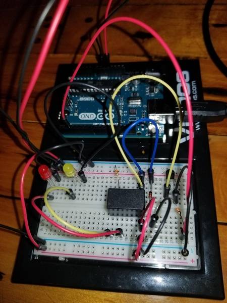

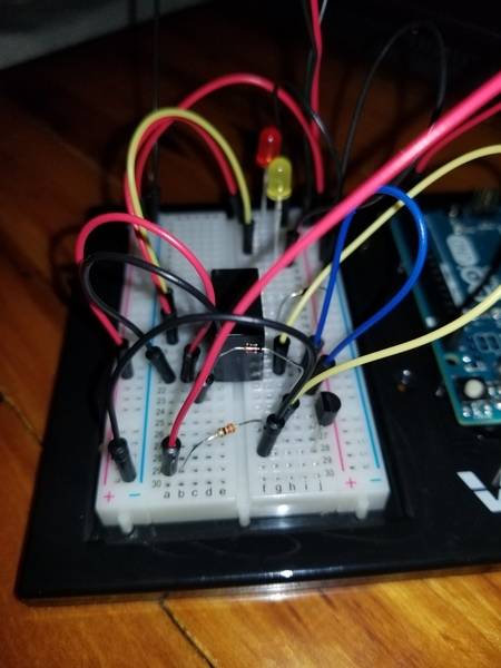

I am doing basic tutorials with an arduino but I can't seem to get this circuit to work. I hooked everything up and ran the given code but nothing happens. The relay is supposed to trigger the led's on and off but when I run the code the relay isn't even making any noise

most of your images are missing
show us your circuit diagram(s) for the circuit
also show the code for the micro
Have you tried running everything off battery power (or wall wart) instead of USB? Without seeing a schematic or relay number that would be my guess.

It concerns me that so many circuit experimenters seem to present their questions in the form of pictures of a breadboard layout. Am I so old fashioned in expecting a symbolic circuit diagram? I wouldn't expect someone with an arithmetic problem to have it presented in terms of piles of beans. I wonder if it's the general habit to work with wires and components, directly form the device spec sheet. A breadboard realisation of fast circuitry - or even slow analogue - can be full of parasitics.

Have you got a multi-meter and done some basic checks? eg is power getting to all the places it should? Is there any evidence the code is running? eg is the pin that drives the relay changing? That check alone might narrow the problem down to one half of the circuit or the other.

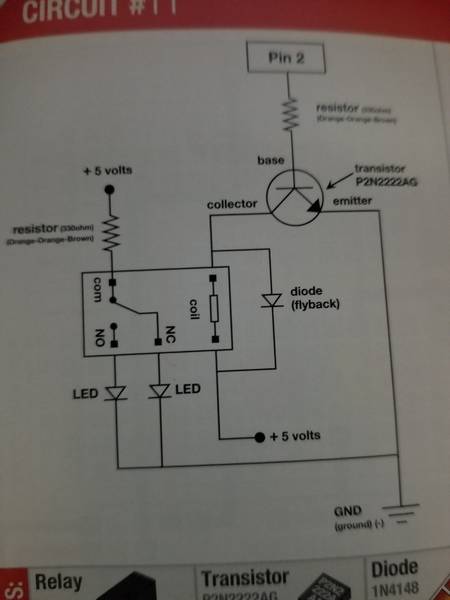

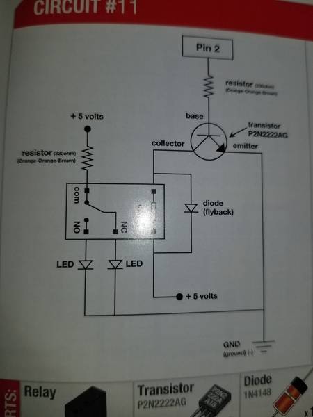

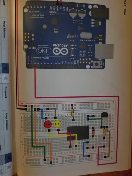

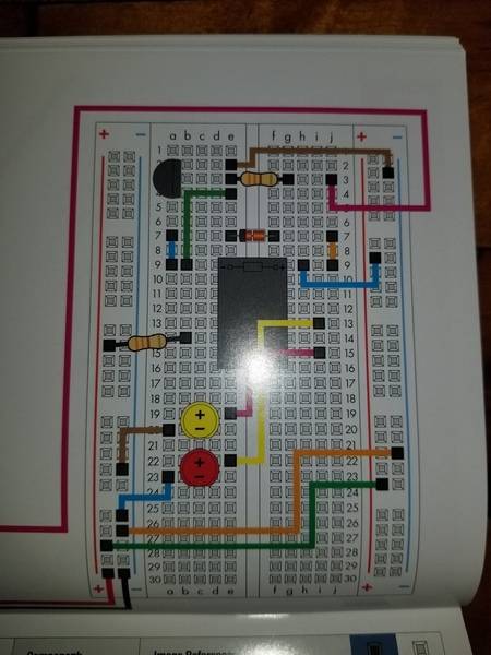

Okay I just posted them
Troubleshooting:
The purpose of the following is not to make you feel bad - it's exactly what I (and the others here) would be checking from the very start)
Take nothing for granted about what you have done. Assembling circuits is an alien world for most people.
First of all, do you have your supply volts and ground actually arriving at your breadboard (both places) and processor?
Does the processor actually give you a different voltage on Pin 2 when it's supposed to? That test will determine if your code is ok. If that's a fail then look again at your code.
Are all the leads firmly in contact with the holes on the board?
Does the collector volts go 'down' when Pin 2 volts go 'up'?
I forgot - the most important is to check (twice) that the connections really are on the correct pins and not on a 'mirror image' in your head when you are looking at the thing upside down? (Happens every day!)
Is the transistor emitter actually connected to ground?

Are either of the LEDs lit?
If +5V and 0V (ground) are connected to the circuit then the LED on the N.C. relay pole ought to be on.

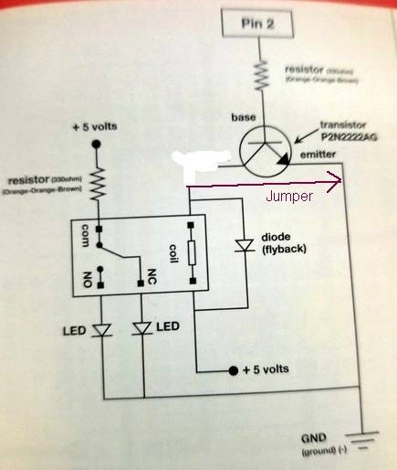

To isolate the transistor and Arduino output pin 2 from contention, temporarily disconnect the transistor collector wire, and jump it to ground. The relay coil should energize, switch the contacts, and the other LED ought to turn on.
If the relay doesn't switch, then a problem exists in this 'half' of the circuit.
If the relay operates, and the other LED turns on, then the problem is on the Arduino/transistor side.

My two cents: I believe it is also possible that your arduino board is sourcing too much current (coils+LEDs). That gives you an error message "problem uploading to board" when you try to run the code. What is the current rating of the relay coil? Try using a separate 5V supply to feed the coil.

This is a great idea, and has shaken loose another possibility ... is the Arduino USB cable plugged directly into a computer USB port, or is it plugged into a USB hub? An unpowered USB hub doesn't have much current sourcing capacity, and more often than not, doesn't have the juice to power an external HDD.

Is the diode the wrong way around?
EDIT: Scratch that - the diode IS the wrong way around, even in the breadboard diagram. Not your fault. The circuit diagram is correct. Give the person who drew the breadboard diagram an insulting slap across the face.
yup, good spotting
the flyback diode is reversed on the breadboard layout :smile:
result ... the relay won't operate
As @sophiecentaur said earlier, this is why we wanted the diagrams etc so we could check for errors
NOTE ... DONT DO Asymptotic's test UNTIL you have reversed the diode and checked operation, else you will just be shorting the 5V to ground via the poor diode and it probably won't survive that
