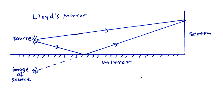

Are you thinking of something like the Lloyd's mirror interference setup? The source and its image in the mirror act like the two slits in the usual two-slit interference setup. A single photon follows either one path or the other. If there is no "which-way" information, the two paths interfere and you build up an interference pattern on the screen as you send more and more photons through the system, one after the other.

Yes that's exactly what I was thinking of, thank you very much. I didn't know there was an experiment for it.
Most optics textbooks describe it, along with a variation called "Fresnel's mirrors" which uses two mirrors to produce two virtual sources that interfere. I don't know if anyone has done a one-photon-at-a-time version.
