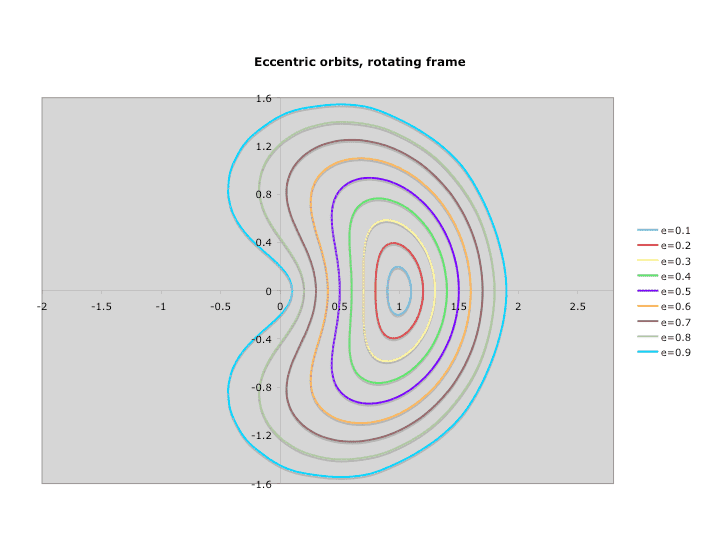

sophiecentaur said:
But the upwards force on your bum is surely no more real; it stops when you take the floor away.
The floor and the force it exerts most certainly are real. Of course you can test the hypothesis that it isn't real by jumping off the top of a tall building.
And how about the equivalence principle? Gravity and acceleration are equivalent are they not?
Yes and no. A lot of people misinterpret the equivalence principle. The equivalence principle says that no local experiment can distinguish between free-falling through empty space versus free-falling in a gravitational field.
Suppose you are in an enclosed spaceship (elevator car in Einstein's formulation). You feel a force from the floor of the vehicle pushing up on you. The vehicle might be out in space firing its engines or it might be standing still on the surface of a planet. Ignoring that the planet's gravitational field is not uniform, there is no way that you can tell the difference between these two scenarios. Now suppose instead that the vehicle is not firing its thrusters and that you are floating around inside the vehicle. Is this the vehicle is in deep space, far from any gravitational source, or free-falling (e.g., in orbit) about some massive body? Once again, you cannot distinguish between these scenarios using only experiments conducted within the vehicle.
