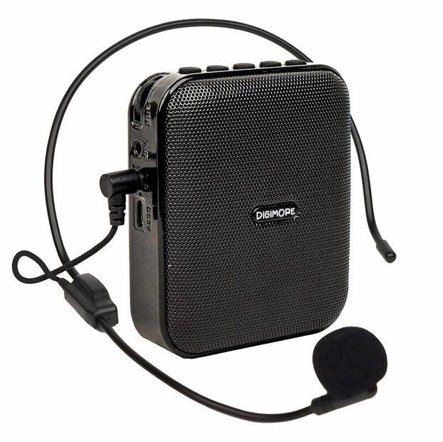

I just bought one of these things...
described as a "Portable Rechargeable Mini Voice Amplifier for Teachers with Wired Microphone Headset and Waistband". (Not pasting the link here, but a search for the description should bring up similar generic items on Amazon). I'ts a box that comes with a Mic, allowing you to record and/or amplify your voice, and it can also work as a regular Bluetooth & MP3 player.
And, it has a USB port where you can connect a USB drive for recording, playing and transferring audio files.
But having just plugged in the drive, it occurred to me that this device does complex enough stuff that it might be running some kind of Lite OS that could be capable enough to be a vector for malware etc., including perhaps cross-platform baddies. So how likely is that, how much should one worry about this kind of vector?
I will be transferring files from the USB drive to a Raspberry Pi which I use for various experiments and for general web browsing, including reading Physics Forums, watching YouTube etc. It would be a pretty big nuisance if something bad were to happen to the Raspberry Pi's current OS installation and contents.

Let's assume for a moment that my USB storage (SanDisk branded) is genuine and free from bad stuff before I plug it into the audio box that I have just bought.
So now, the box's bad firmware would set up the USB storage to emulate a keyboard after it is plugged into my computer?
Some stuff on Amazon comes from small vendors in China as an example. Suppose it got infected there or was designed to only infect certain types of devices or copy a malware package onto your San disk stick then you could wind up with a virus infection.
I think in your case, this is highly unlikely though. You could and should make a backup of your PI boot drive for this kind of scenario.

The product in my original post is, of course, not a well known brand and it could well be sketchy.
As a matter of theoretical interest, how much extra safety would you say the following strategy might offer:
  • I have an oldish phone that I haven't been using.
  • I would delete all apps that it allows me to delete, in general bring it to a pristine condition.
  • Connect the USB drive to it via an OTG cable.
  • Copy the files to the device storage then unplug the OTG.
  • Connect the phone to my Raspberry Pi and use strictly only Media Transfer Protocol (MTP) to transfer the files to the Pi.
My impression is that MTP is pretty much sandboxed compared to conventional file transfer via USB (where the phone looks like a full fledged storage device).
Another option might be to create a Google account just for this purpose and upload to Google Drive from the phone.

I'm going to stick my neck out here and say that providing you only plug in USB memory sticks from a known origin (i.e. you have purchased them yourself) you are worrying about nothing.
The attack vector mentioned in #2 is not a malicious file on an ordinary device, it is a malicious device - a computer that masquerades itself electronically as a keyboard and physically as a memory stick.
As long as you are not stupid enough to execute any program stored on a genuine USB storage device (either manually or by confirming any "do you want to run autorun" OS prompt or by copying it locally and then executing it), it cannot harm you.
Note that by plugging something that is not a memory stick (e.g. a phone) in you are actually creating a risk that does not otherwise exist (e.g. the phone may be root-kitted with keyboard emulation malware).
Don't do this.
