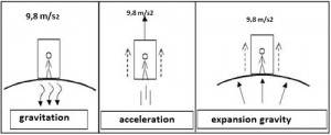

Nobody can explain HOW this equality would found in real world. There are a few theories that support the idea that all matter expands and that there for the expanding Earth causes acceleration in a way that is explained in this drawing:
I have never seen any scientifically accepted theories based on the expansion that you mention. Usually it's just an misunderstanding of General Relativity.
In GR's curved space-time, proper acceleration of the surface away from the center doesn't imply expansion of the Earth. It just means that the surface doesn't have a geodesic worldline in the curved space-time. The world line bends upwards, just like the one of the green apple in the video above, but the distance to the center (Earth radius) is constant.
