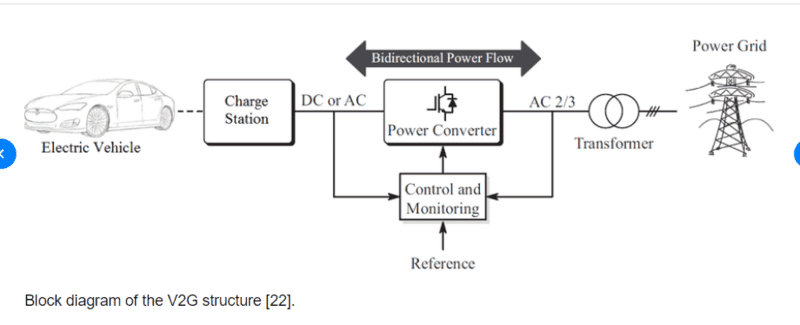

How can electric vehicle deliver energy to grid?
This is the one of the few block diagrams that I could see in google. Do you have better one or can you explain this one? If I am not wrong. V2G is basically giving excess charge in your EV back to the grid.

shivajikobardan said:
How can electric vehicle deliver energy to grid?View attachment 300746
Many renewable energy source output DC directly (like solar panels) which is then put into grid inverters that use semiconductor switches and low pass filtering to output AC that can be attached/supplied to grid or directly used in household systems.
An electric vehicle has a battery and batteries are DC storage sources, that means that the EV battery is in electrical terms just another energy source that much like a solar panel can be fed back into grid via an inverter.
In this regard it is almost identical to a solar panel, just that it doesn't produce the energy it has it simply stores it. Much like a pumped storage hydro plant just with different physics behind it.
The common idea is that once EV's will be plenty the total battery capacity will be large and if enough users driven by profit used their EV's to supply peak demand then the EV car fleet would function as another grid stabilizer, aka energy storage system, similarly to how pumped hydro and hydrogen fuel cells work.
But unlike pumped hydro and other industrial storage solutions, EV's are private and scattered around and I'm not sure whether one will be able to get an accountable and systematic charge/discharge ratio out of this.
Another downside is that every charge/discharge cycle shortens the battery life, and using your EV car to stabilize grid is not a straightforward "green" or viable solution to my mind.
Battery's cost a lot and use a lot of toxic chemicals that are not easy to produce and take great care to recycle so I think this is a two way road.
Can you do it? Yes.
Is it a good idea? Possibly, but probably not.
