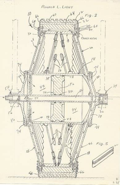

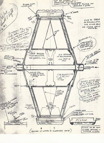

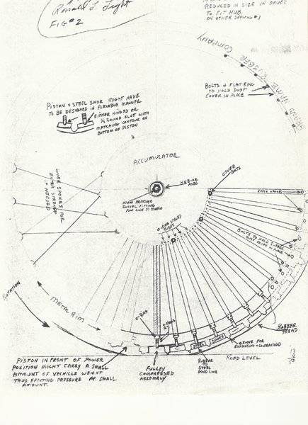

In line with what you are saying, a method to have weight transformed into forward motion is something I tried to get patent coverage in 1978 (no success) :frown:

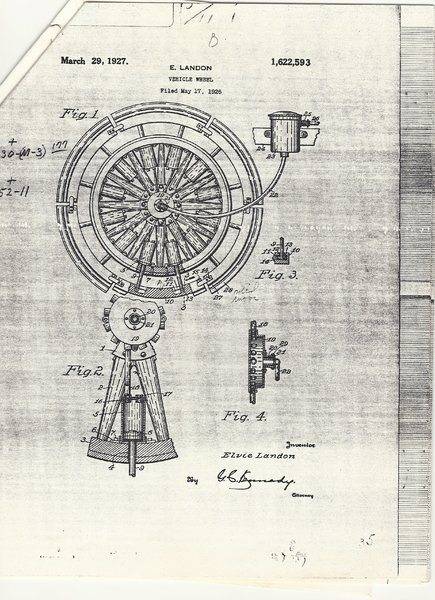

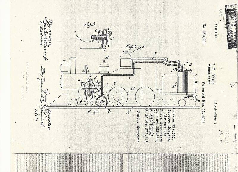

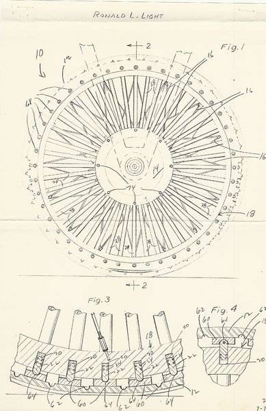

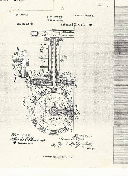

The weight to energy system with all the "might be's" and "could be's" is very close to a lot of perpetual motion proposals which have been brought up for the last 200 years. That is why it got rejected. There is no free lunch.
These are the drawings used by the patent office when they rejected my claim...
The intent of my drawings are to capture some amount of momentum energy, when slowing, braking, or a downward grade, with the use of hydraulic flow and storage.
My idea originated on a trip to Florida, observing wheels, hitting puddles of water on the highway, at speed. The thought of capturing some of that energy with a fluid in an enclosed and controlled condition, along with the knowledge that I can't lift a car but I can push it, on a few occasions using a forward push of about two or three feet, I have lifted a car up onto a six inch high slab. (momentum transformed into lift)
It is not a PM idea, but merely a method of otherwise wasted energy being captured and stored for reuse.
View attachment 208107 View attachment 208109 View attachment 208110
The concept is a good one, it just depends on the details. How much energy can be captured, stored and released at what cost? Regenerative braking used today in some electric cars seems fairly straightforward. Maybe your concept has a different application...Your lawyers should have helped you rewrite the application in a way the USPTO would understand but apparently they didn't do that.

RonL said:
I hope my insertions of drawings and my thoughts about your question has not been interpreted as a thread hyjack in any way, I feel very strongly that the idea of weight transformed into hydraulic pressure flow has some merit. Looking forward to more interaction from others, as I feel this is a very good topic.
Thank you for asking the question. :smile:
By the way, I wanted to ask what you meant by 'weight transformed into hydraulic pressure flow'?
That was when I was young and living like a church mouse, they did offer to continue, but I was not sure if they were trustworthy and I just did not have the funds to go further. :frown:

If you have ever used a hydraulic jack to lift a weight, then when you release the check valve there is a weight generated pressure flow of fluid back into the reservoir.
