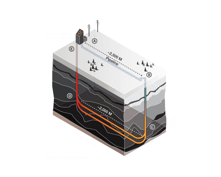

Hi
I got a curiosity based on a Geothermal case: depth of the well: 3500m with a temperature of around 90 degrees C at that depth. (I think it will require an ORC cycle, like the primary fluid in the subsurface (collector-pipe) would be the water and at the surface within a 'steam' generator/HE or so, the organic fluid that will quickly vaporize due to its low boiling point.
I want to do sensitivity analysis, such that I can change the length and the flowrate to see how much MWe can get out.
Basically this would be a closed loop geothermal system for electrical power generation. The system would consist of 2 Horizontal Wells connected creating a U-shaped closed loop cycle using thermosiphon effect, with constant recirculation. It's not really a conventional geothermal power generation, more of a ground-source heat pump that generates electricity due to ORC (Organic Rankine Cycle), where water would be heated up, being the primary circulating fluid in the subsurface (geothermal collector - pipe, probably cemented in place), and an organic fluid at the surface that will vaporize quickly turning the turbine and producing electrical power.
This system would be different from the conventional geothermal power generation due to the fact that in this specific case the geothermal source would act as a heat exchanger, heating up the Well casing and hence the water inside it. (Please see Figure 1 attached below for more details).
Input data:
Well Depth: 3500m
Temperature at that depth: 90 degrees C
Input data that can be adjusted:
Subsurface length: 5000m
Flowrate: I have to figure it out, but this can be adjustable as well.
Casing (geothermal collector piping) outer diameter: this can be adjustable as well: I'd take that initially around 5 in
Organic working fluid type: have to make an assumption here as well, like R134 or Toluene
Output:
x MWe (in the attached Figure, around 2 MWe) by changing the length and the flowrate, have to find x.
My take is that water will flow down the geothermal collector, and I guess the length should not be too small otherwise the water won't heat up enough, and the flowrate shouldn't be too high due to the same reason.
I guess this should be a heat transfer problem, and then I have to figure it out how to generate electrical Power in MW based on the ORC (Organic Rankine Cycle). In the attached figure the electrical power is around 2 MWe, and I'm trying to figure it out how they came up with these calculations.
Any suggestions/guidance on the calculations would be more than appreciated!
Didn't you mean 2 vertical wells? If I understand correctly, the Rankine cycle is carried out on ground level. You are transferring heat to the water (which comes from where? and is discharged where?).
Hi,
Thanks for the reply, I appreciate it.
Yeah, you could say that they are 2 vertical wells, which are connected horizontally, making a U-closed loop cycle. The horizontal casing (pipes-geothermal collector) are probably cemented in place. Basically two vertical wells several kilometers deep with many horizontal multilateral wellbores several kilometers long.
The geothermal heat source acts as a heat exchanger as far as I understood. Water is being pumped down the well, and it undergoes a closed loop cycle, so it's being recirculated (you can see the process in Figure2 from A->E)
Those 5 km long horizontal holes will be difficult and expensive to bore.
Maybe consider a horizontal formation of porous sandstone as a heat source. Two vertical wells then provide access to the formation without need for critical underground navigation.
In Australia, energy was extracted from the heat of the artesian flow, but now flow is restricted. You are considering a closed loop or recharge of the aquifer.
https://en.wikipedia.org/wiki/Great_Artesian_Basin

Hi,
Thanks for the reply! It's just an example at the moment, I'm trying to get the gist of it.
Figure 2 in post #3 for example has 2.4 km depth and 2km length in the subsurface, indeed I am considering a closed loop system.
In this specific example the geothermal heat source acts as a heat exchanger to heat up the water circulating through the geothermal collector. Then at the surface I think it would require ORC to generate power, since water is like at what? 90 degrees C. I am still trying to figure it out what equations to use to estimate electrical power output in MWe.

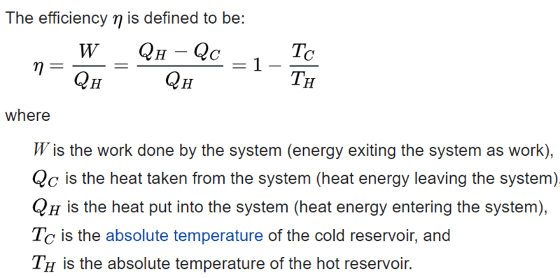

Martin Harris said:
Any guidance on the equations needed for the calculations would be more than appreciated!
In that case, I recommend that you stop with the Carnot Efficiency limit. That's easy to calculate.
From https://en.wikipedia.org/wiki/Carnot_cycle
Caution: absolute temperature means degrees Kelvin.
To go more, like electricity generation, you can't be general. You must be specific as to the method and design of the apparatus to convert the heat to electricity. That could be a year's effort just to figure it out.
Hi there!
Thanks for the guidance.
I did calculate the efficiency
η =1 - (35+273.15K)/(90+273.15K), so that's roughly 15.14% as BvU stated.
Now, regarding the electricity generation, I want for the moment just to get the gist of it, a rough estimate, since I'll add complexity later.
Any idea on the steps that should be followed for the power generation estimation?

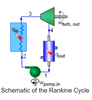

Hi there.
Thanks for the reply, it makes sense, yeah, sorry for the overcomplication.
So, I guess yeah, it can be assumed to use air cooled condenser. As far as I'm aware there are 2 options
a)A literal air cooled condenser where we condense vapour with air
b)A Heller-style system where the condenser with water and then use a giant heat exchanger to cool the water with air
For this example I'd go with a), now I am thinking how can I try to shove the input data from Figure2 below within calculations to obtain electrical power output in MWe, so they won't be silly and plain general.
As for the heat sink, it can be ambient air, yeah, so I guess for simplicity we can assume 25 degrees C, and around 70% humidity, whereas the geothermal source would be at around 90 degrees C, and the inlet water temperature around 35 degrees C.
Once you know the Rankine design, you know the hot water rate at 90 C required. You then need to determine the size of the pipes underground to deliver that hot water rate, while heating the water to 90 C. You know the buoyant pressure driving force.

For water I did initially Q = m*cp*delta T.
Basically I assumed that the heat duty in the underground depends on the delta T and on the mass flowrate of water being circulated in the closed loop. The higher the mass flowrate, the bigger the length of the pipe. Delta T and cp can't really be controlled, so just the mass flowrate. Now I have multiple heat duties scenarios based on the mass flowrate variation.
My outer diameter OD of the pipe would be 4.5 inches
A reasonable water mass flowrate in the underground would be around 15 kg/s, but how can I get the length of the pipe for this flow rate?
Then in order to get electrical power output I assumed a conversion factor of about 10% to transform the heat duty intro electrical power output.
Question is, how can I get the length of the pipe based on the water mass flowrate in the underground?
So I have a temperature in the underground of around 90 degrees C, and I will pump down water from an inlet temperature of about 35 degrees C through the pipe with a mass flowrate of about 15 kg/s within a 4.5 inch pipe, to heat it up to 90 degrees C. Now the question is, how can I figure out what length of pipe do I need to accommodate in order to fulfill this process?
