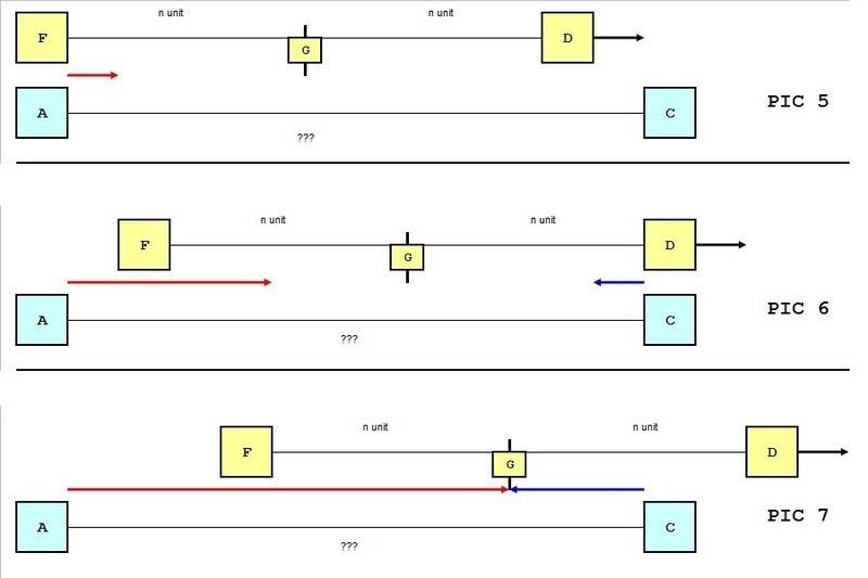

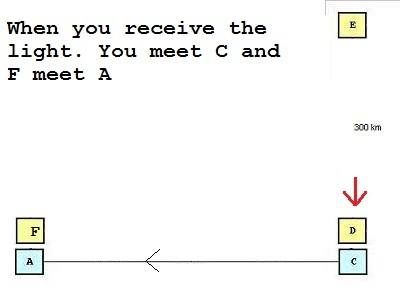

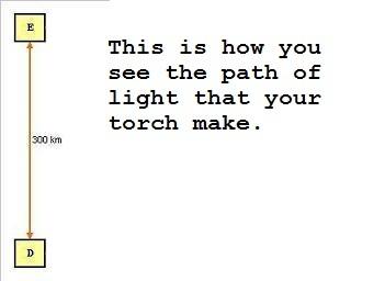

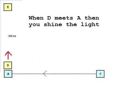

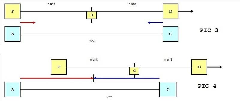

You (YY) are moving 0.5c to the east, and Alice(AA) from your east is at rest. Y2 is your friend far away from you at east and is comoving with you, that is he travels 0.5c to the east also.
Or Alice will say that it's you who are at rest, and she travels to the west at 0.5c
A2 is Alice friend's who is comoving with her. That is, A2 is traveling to the west at 0.5c
Let's say the distance between YY and Y2 is 1000 light seconds or 300 millions km wrt you!
The distance between A2 and AA is 1000 light seconds wrt you!
Wrt Alice A2 and AA is ##1000/\sqrt{0.75} = 1154.7 \text{ seconds or } 346.4 \text{ millions km}##
But YY and Y2 wrt Alice is ##1000*\sqrt{0.75} = 866.03 \text{ seconds or } 259.8 \text{ millions km}##
Be careful, there will be length contraction and relative simultaneity of event that will come later.
BB is Bob which we will use in later case.
Okay, so here's the picture.
....BB........B2
....YY........Y2
...<------AA........A2
Surely, you will see Alice who is moving toward you at 0.5c to the west and when A2 meets Y2 then A2 shines a light. This light will reach YY 1000 seconds later wrt you, blue shifted. If you don't move 0.25c.
But what if you move 0.25c to the west? There will be two of you here. One who was at rest, and the one who is traveling 0.25c to the west.
So, let's add Bob (BB) who is at rest in your first frame. And now you moves 0.25c to the west wrt Bob. Let's see when YY receives the signal
And let's put B1 at some distance where when YY receives the signal YY will meet B1.
...<---YY.......Y2 ...
......B1...BB.......B3...B2
...<------AA........A2.....
This can be solved by simple algebra.
##0.25T + 1000 = T, T = 1333##
So when YY receives the signal the clock show will 1333. B1 clock not YY clock!
What does YY clock show?
Time dilation.
##\gamma = \frac{1}{\sqrt{1-0.25^2}} = 1.033##
##1333/1.033 = 1291##
YY clock will show 1291 not 1000 not 1333. And the light still travels at c wrt you (YY).
How come that be?
So the only explanation for this situation is this.
Facts that you and Bob both agree
1. When BB meets YY and B2 meets Y2, all of you synchronize your clock.
2. Then A2 meets Y2 and (of course B2) and A2 sends a signal to the west and at that time YY and Y2 moves to the west at 0.25c
3. Now this is tricky. You change frame.
In your new frame, it seems that the light comes further back from Y2.
I think this is rather advanced, although for some people this is very, very bacic. Perhaps you ask about read time dilation, length contraction and relative simultaneity of events.
And the answer about your two detector should come after that. There's a relative simultaneity of events there.
I hope I give the correct answer and the right answer, the answer that you're looking for.
Sincerely
