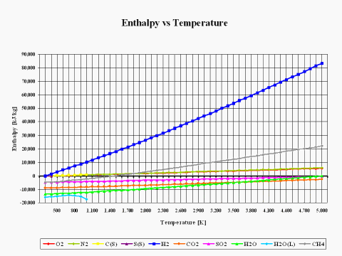

Hi there:
This is a good question, but it is a tricky one.
With dealing with steam, you have steam tables and there is no problem. Physical properties are given as a function of both pressure and temperature. Such values have been experimentally measured.
When dealing with gases, combustion, it is another ball game.
Knowing that for ideal gas one can use the state equation as pv = RT, enthalpy values are given as a function of temperature only -- h = u + pv = u + RT = cpT.
For basic combustion calculations this is just fine when calculating the flame temperature.
However, when dealing with combustion products over a huge pressure and temperature range, this is not acceptable. In order to get aceptable numerical values, the minimization of Gibbs free energy for the combustion products is used. Such values are given as function of both pressure and temperature. Such calculations cannot be done by hand.
Here are s few URLs that can be of some help to you:
Technical background information on the physical properties
http://members.aol.com/engware/properties.htm
Physical properties online calculator
http://members.aol.com/engware/calc1.htm
Technical background information on combustion
http://members.aol.com/engware/components.htm
Combustion online calculator
http://members.aol.com/engware/calc4.htm
Thanks,
Gordan
PS
If you need additional explanation on the subject matter, I am here to help you out and share a few sample problems with you. Again, this is not an easy subject matter and it takes time to realize and digest what is at stake ...
