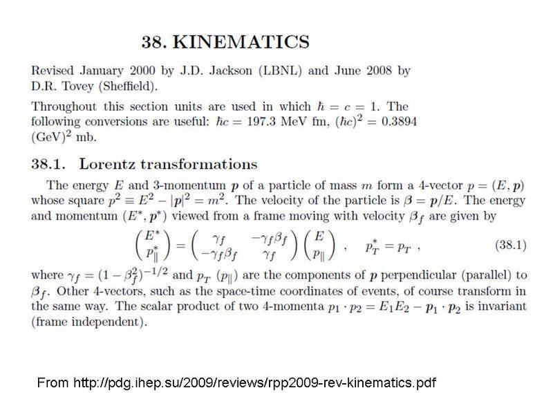

Consider a hydrogen atom with the electron emitting a 2p-1s transition photon (~10.2 eV) in the y direction transverse to its motion with velocity βc in the x direction. What is the energy, direction, and mass of the photon in the moving frame?
Use Lorentz transform (in thumbnail)
In hydrogen atom rest frame, the photon is:
E = 10.2 eV =pyc, and pxc = pzc = 0
The photon mass is M2 = E2 - (pyc)2 = 0
In moving frame:
E* = γE
pxc*=- βγE
pyc* = pyc = E
pzc* = 0
Photon mass in moving frame is
(M*)2 =(E*)2 - [(pxc*)2 +(pyc*)2]
= (γE)2 -[(βγE)2 + E2 ] = γ2(E22E2) - E2 = 0
Photon has no mass in moving frame.
angle in moving frame is θ = tan-1(pyc*/pxc*) = tan-1(1/βγ)

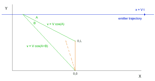

[edit]
The scenario is shown in the picture. The tube has end coordinates (0,0) and the (0,L). The emitter travels along (V t, yE ). We can define the tube in 4 dimensions by imagining a light beam emitted at the bottom end and sent to the top end. This gives a 4D position vector of the event when the light reaches the top ( L/c, 0, L ). From the emitter frame this transforms
[tex]( L/c,0,L) \rightarrow ( \gamma L/c, \gamma \beta L/c, L)[/tex]
The x-coord of the top moves left, tilting the tube. I've cheated by choosing axes so the bottom doesn't move, but it shows the effect.
The important thing is that the bottom and top of the tube have different relative velocities with the emitter, and so the change in the x-coords will be greater at the top than the bottom, giving the tilt. As the emitter passes over the tube, it appears to the emitter that the tube becomes vertical then starts tilting the other way.
Because every point of the tube has a different relative velocity with the emitter frame, the tube will appear bent and tilted.
I could have got this wrong but it seems right.

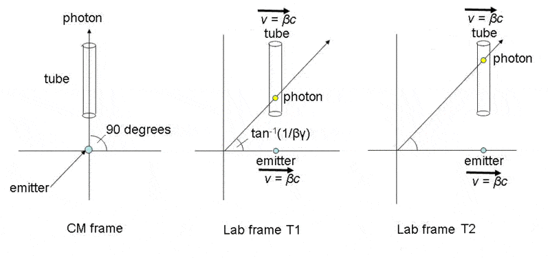

Austin0 said:
4) Given the picture I have so far it would seem impossible for any photon to have a straight linear path orthogonal to the emitter motion.
That if there is a light detector at the end of a long light absorbtive tube aligned directly perpendicular to the source motion that it would seem impossible for a photon to reach the detector??
Look at it this way. Consider an emitter in the CM system emitting a photon in the direction perpendicular to its direction of motion at velocity βc with respect to an observer in the Lab system. The photon is moving down a long straight absorptive tube, at rest in the CM system. Regardless of the velocity of the emitter and the absorptive tube relative to the observer, the photon will always exit the end of the tube, independent of the emitter's velocity in the Lab system. The observer sees the photon exiting the absorptive tube, at an angle θlab = tan-1(1/βγ) relative to its direction of motion. (see Post #4).
So why does the absorptive tube appear to be rotated in the Lab system? It is due to the Terrell effect:

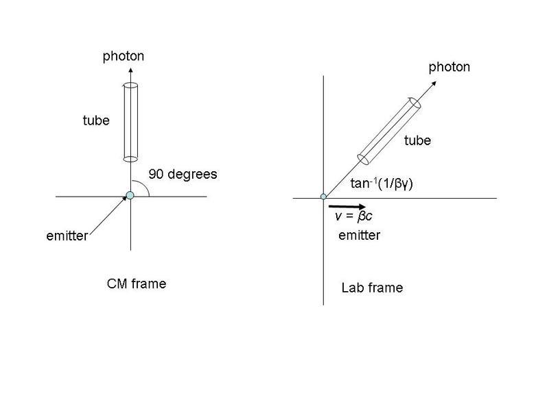

If the tube and detector are both in the Lab (observer's) frame, then the tube tilt angle is
θlab = tan-1(1/βγ)
as shown in my earlier post #4. The tube is not bent in the lab frame, nor is the observed trajectory of the emitted photon. If the photon reaches the end of the tube and the detector in the lab frame, then it will also, when observed in the CM frame.
Bob S

The tube in the lab cannot be orthogonal to the direction of motion; it has to be at an angle
θlab = tan-1(1/βγ).

If the tube is stationary in the lab frame, then it has to be aligned at an angle θlab = tan-1(1/βγ) relative to the direction of motion.. If the tube is stationary in the rest frame of the emitter, it has to be aligned orthogonal to the direction of motion.
Bob S
Bob S

Austin0 said:
Hi Bob S I am sorry but I am still unsure as to your meaning.
1) It has to be aligned at angle tan-1(1/βγ) in order for the photon to make it through??
2) If it is orthogonal to the motion of the emitter in the lab frame , the photon will not get through to the detector??
So are both of these true?
Thanks for your patience
(1) is always true: "aligned at angle tan-1(1/βγ) in the lab frame".
(2) is always true, unless the emitter is at rest in the lab frame.
[added] See thumbnail
Bob S
Bob S
The equation you quote is correct for the angle of the photon's trajectory relative to the motion in the lab frame, but the tube does not rotate in the way your diagram suggests. See the attached modified diagram for what actually happens.
If the tube is aligned orthogonal to the direction of motion in the CM system, and a photodetector at the end of the tube verifies that the emitted photon reaches the photodetector, then any observer in any moving reference frame will also observe that the photon does indeed reach the photodetector. So how can you say that an observer in a moving reference frame will see the photon blocked by a misaligned tube? Or are the laws of physics different in different reference frames?
Because the photon velocity is the same in all reference frames, the observer sees the photon at different locations at different times depending on time of flight, and her distance from the location of the photon. The same holds for the absorbing tube. So maybe the Terrell effect is relevant. In any case, all observers will agree that the photon hits the detector.
Bob S

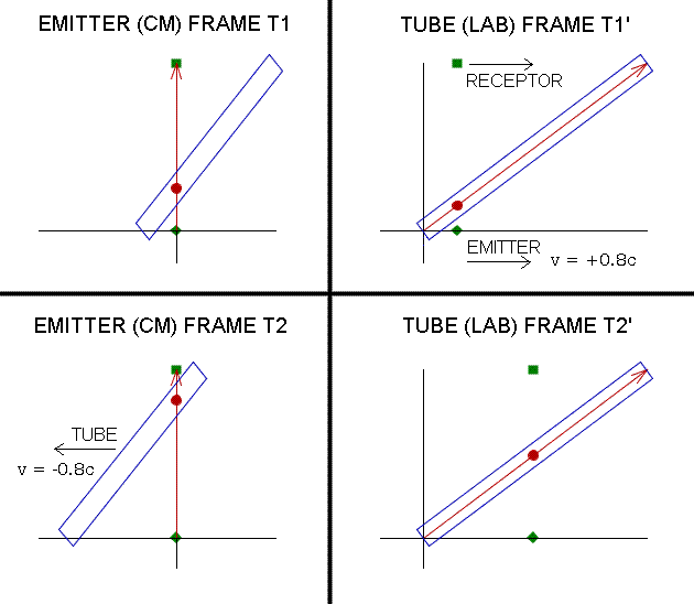

The tube rotates in the moving frame , this was established in the another thread on the Thomas-Wigner rotation. In fact, the Terrell-Penrose effect is nothing but another facet of the Thomas effect.
The light beam also appears inclined in the moving frame due to the well-known effect of aberration. For the particular case of light traveling along the y-axis in frame S, it will travel at an angle [tex]cos(\theta')=\frac{cos(\theta)+\beta}{1+\beta cos(\theta)}=\beta[/tex] with axis Ox' in frame S'. This is exactly the same angle the tube rotates as well, so both light beam and the tube rotate by [tex]\theta'=arccos(\beta)=arctan(\frac{1}{\beta \gamma})[/tex]. So the photon does not hit the sides of the tube in either frame S or S', it travels perfectly centered along the axis of the tube in both frames.
ETA : If it iwere any different we would have devised an experiment that violates PoR :-)
