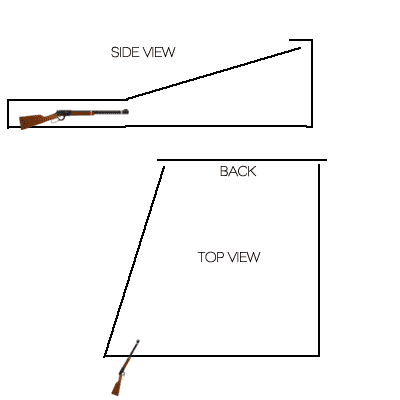

so what type of shape would the room be to help attenuate? just a std rectangle, a < sign, a polygon, corrugated, a < shape where the ceiling has a sin(x) ripple, etc ?
No two walls should be parallel. That reduces standing waves.
this is a method o know of from a recording studio design.
so, flat floor, ceiling that opens up like <, and then one side wall that comes in at an angle.
i am looking at a panel system for the ceiling that has end result like corrugation. then i plan to use sound deadening foam sheets to cover walls and ceiling.
