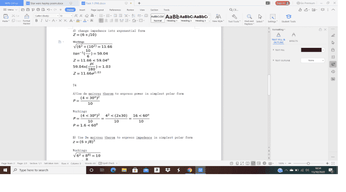

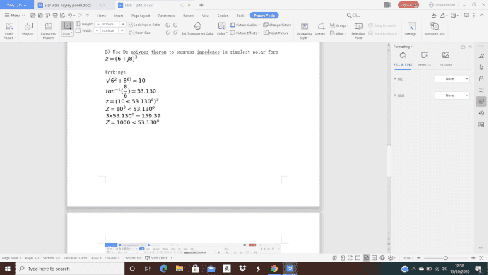

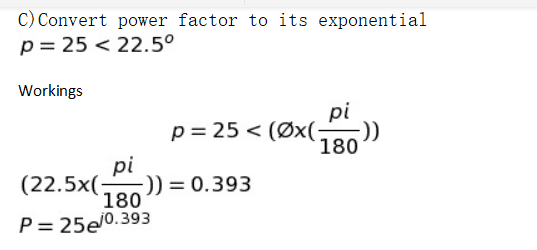

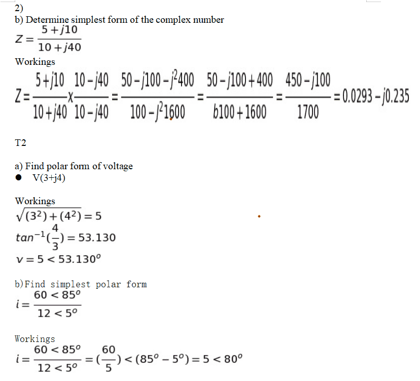

Can somebody check my assignment
I did it just need check before submitting

I'd like to help, but wow that's really hard to read. Can you use a Snipping Tool to just take screenshots of the work, not including the overall display window stuff? At least that would be easier to read. Thanks.

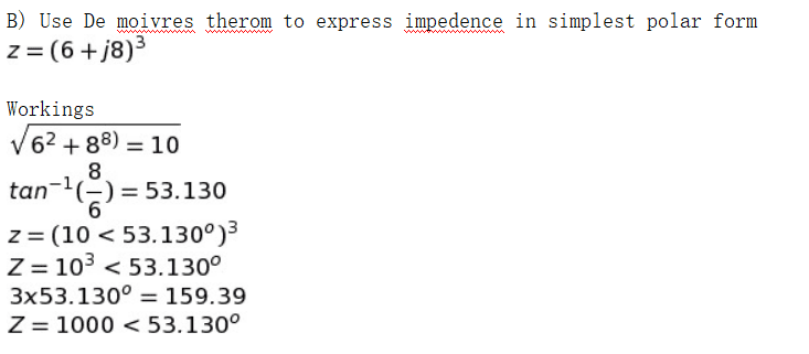

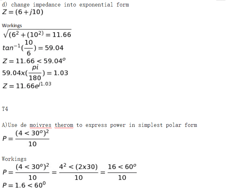

That's a lot better, thanks! I'll have a look at it in a few minutes if nobody else beats me to it.

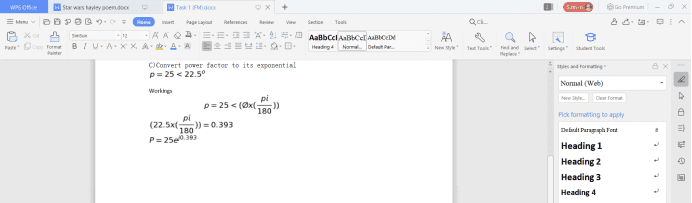

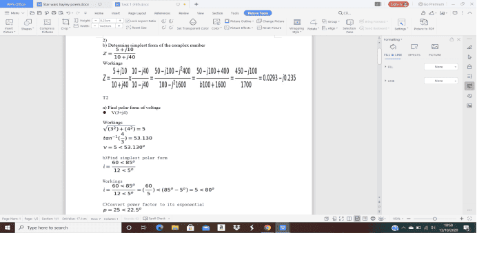

First three look fine: 2 b), T2a and T2b.
I didn't check the others.
In the future, please post no more than two questions in a thread. With so many questions in a thread, it's hard for people to keep track of what has already been responded to.
Your work for 2 b) is correct until the final numerical value. Note that 450/1700 is not equal to .0293 for example.

Most of the rest looks good too. Note that in T4 d) the square root symbol overbar extends over the result as well. You got the right result, but be careful about ending the square root overbar on the LHS:

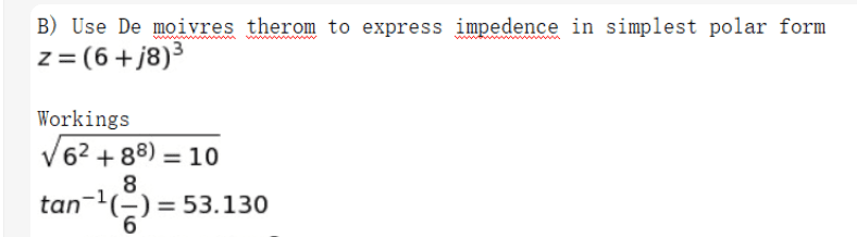

And there is a similar problem in B), but it's worse and I lost synch with what you were trying to do:

sorry can i just check i got it right but the root sign extention was the only wrong thing?
and the J400/1700, which is 0.235 not 0.39 something
