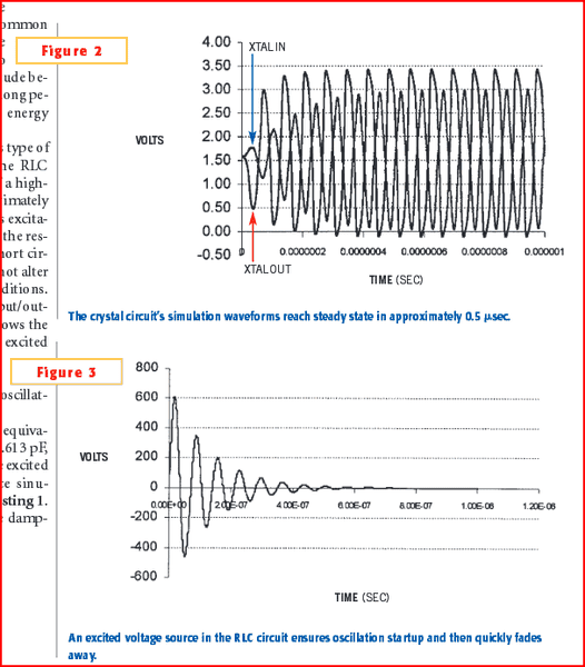

And this PDF has a nice idea for the forcing function to use to "kick start" the oscillator:
https://m.eet.com/media/1148991/22768-52799di.pdf (see page 110 in the PDF version)
They use a damped oscillator input signal to kick start the oscillator and then let the oscillator circuit continue on its own after the exciting waveform dies out. Nice idea... :smile:
Two simulation plots: top, XTALIN and XTALOUT voltages vs time (0 to 0.0000001 sec) reaching steady oscillation near 0.5 usec; bottom, damped oscillating voltage vs time (0 to 1.2E-06 sec) peaking near 600 volts and fading.
  • Two simulation plots: top, XTALIN and XTALOUT voltages vs time (0 to 0.0000001 sec) reaching steady oscillation near 0.5 usec; bottom, damped oscillating voltage vs time (0 to 1.2E-06 sec) peaking near 600 volts and fading.
